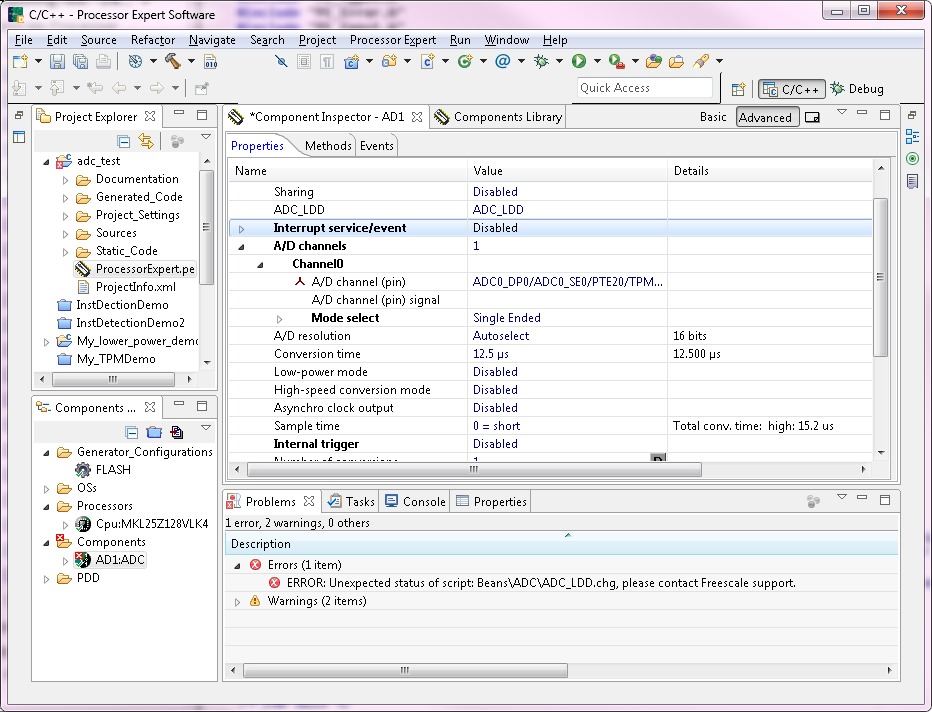

I am doing some test with KLZ25 board with Processor Export.
When I add a ADC component, it works well.
but when I disable its interrupt, there will be an error:
I can not figure out the problem. Does it mean I can not disable the ADC interrupt?
Henry Xin

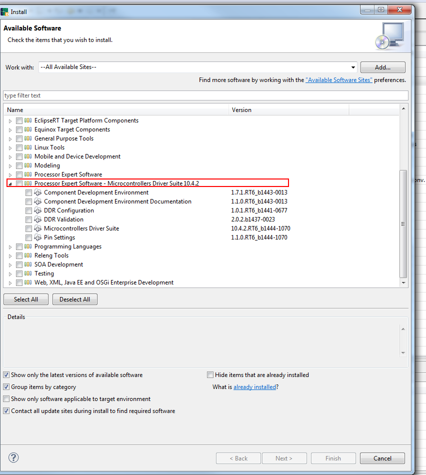

Hi henry,
Please update the Processor Expert Software : help -> Install New Software,
and i recommend you updated other related software if you use .

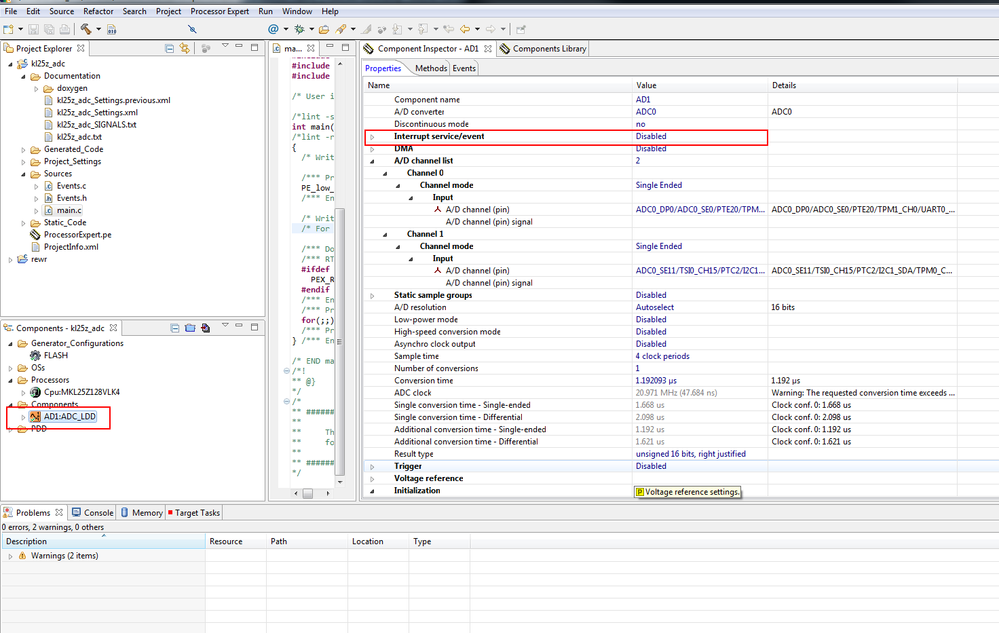

Hello Henry,
On my side , when only add the ADC_LDD component , disable the interrupt , there is no error :
Please tell me which Processor Expert you use ?
And i think it is maybe not the problem of disable the interrupt.
Please create a simple project ,only add the ADC component, then test it .If still have error , please send you project to me , i will test it on my side .

henryxin
Hi Alice,
Thanks for your reply.
But I tried to create a simple project which only has an ADC component, and still got error as:
Following is my PE version information:
Processor Expert Software,
Microcontroller Driver Suite
(c) Copyright Freescale Semiconductor, Inc. All rights reserved.
http://www.freescale.com/processorexpert
Version: 10.4.0
Build: b140319
Henry

henryxin
By the way I used the ADC component in the "CPU Internal Peripherals" category, not in the "Logical Device drivers" category.
Henry

henryxin
Hi Alice,
After updating the PE, It works well with me.
Thank you very much.
