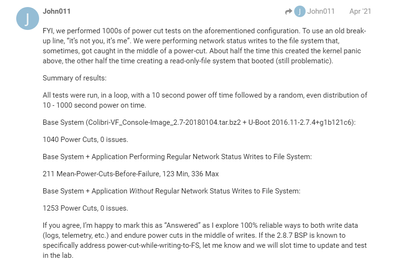

Here i find some reference cases may help you
https://community.nxp.com/t5/i-MX-Processors/UBIFS-recovery-needed/td-p/149849
https://community.toradex.com/t/vf50-kernel-panic-starting-with-ubifs-error-ubi0-2-pid-1/12911/4http...
This issue could relate to NAND or kernel. You can try to replace another MT29F1G08ABAFAH4-AAT:F NAND to cross-verify this issue.
