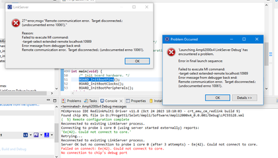

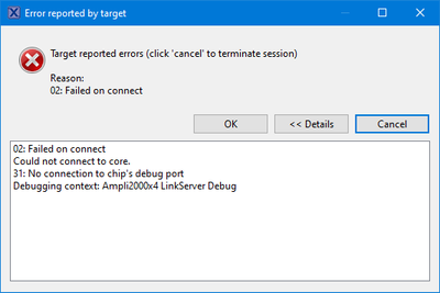

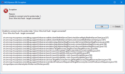

I am developing a project that uses the LPC55S28JDB100 microprocessor. I have just received the board, which I connected to the PC via NXP MCU LINK. I am able to download the firmware to the microprocessor, but when I execute the 'step over' on the BOARD_InitBootPins() routine, the debugging process stops. Probably some Input/Output pin is interfering with the debugging connections. So I try to rerun the debugging session to analyze the problem better, but the following errors are displayed:
and then
I suspect that the software is attempting to execute the incorrect program from the flash memory, which is causing the debugger to lose communication with the device.
Did you have similar problem ?
How did you fixed it ?
Thank you very much for your help and cooperation

Hello @_Ferrari_
1) Is your board an NXP official demo board or do your own board?
2) Please try to enter ISP mode, then erase all flash, then use a simple hello world SDK demo to debug.
3) Debug step by step to check which code run into problem.

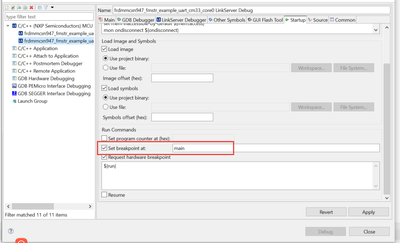

Hello @_Ferrari_
1) Please check whether config "Set breakpoint at:"
2) How about creating a simple project to debug. Pay attention choose the same part number with your chip.
If there is some wrong with project, debug will crash. Need erases flash before next debug.
