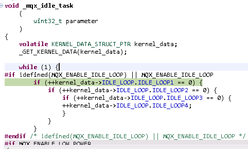

I've been playing with the fsl_uart component, and started with my FRDM-K64F.  Using KSDK + PEx + MQX, I was able to confirm operation of UART3 with some simple loopback test code.
Now I've moved on to the FRDM-K22F.  Also using a similar configuration with KSDK + PEx + MQX, I have not been able to get my loopback code working.  I believe the only difference is that on the K22 board, I am using UART2 (PTD2/PTD3).  The specific problem I am having is that UART_DRV_SendDataBlocking hangs because the inner call to UART_DRV_StartSendData hangs.  I am unable to step into UART_DRV_StartSendData.  My initial impression is that something is misconfigured, resulting in an invalid call (e.g. wrong memory address).
If I pause execution at random times, it seems that the code is always stuck in the idle task.

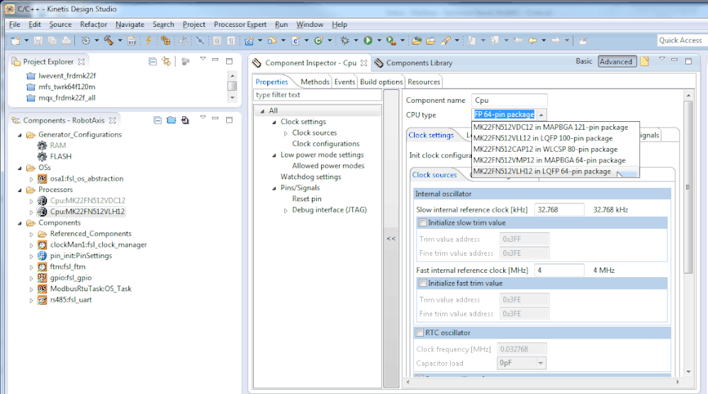

Looking at your project, it has the wrong CPU selected for the frdm-k22f Freedom board.
Please switch CPU from Cpu:MK22FN512VDC12 (a 121-pin package) to Cpu:MK22FN512VLC12 (64-pin package).
David

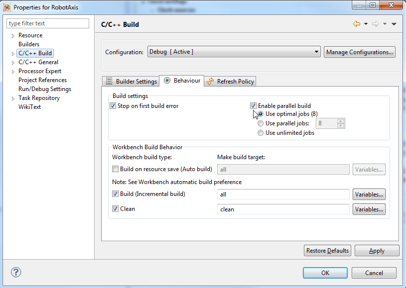

Bonus:  If you want to increase the compile speed please enable "Enable parallel build" as follows....Note this is done a a project by project basis:

dave408
Senior Contributor II
Ugh, how did I do that?  Thanks for catching that.  I had gone through the preprocessor settings and saw that the VDC12 was selected, but didn't think to go into PEx.
That makes sense, because I just created a new project from scratch and targeted the FRDM-K22F, and it worked.  In my project notes I forgot to mark down that I had been targeting a processor in my RobotAxis project, rather than the board.  That must have been it.
Thank you for your time, David.  Sorry about posting such a dumb user error-related problem.

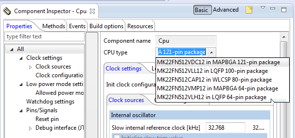

DavidS
Highlight the Cpu:MK22FN512VDC12 Processor that is enabled for your Flash build, then in the Component Inspector - click the pull-down next to CPU type and change away....
Its only simple after you find the solution.
David
