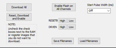

Hello Jose,
Thank you for your help. I have checked everything on DRVEN. Both in the SPIGen (High and Low) through the single command and microcode. I have also verified by scope that the DRVEN is being driven as expected.
I do not see "Enable Flash on CH1 and CH2". I see "Enable Flash on All Channels" (See screenshot). Is there something else?
Robert Maier

reyes
Hi Robert,
Please make sure the DRVEN signal on the “Single Command” or “Microcode”page is set to High.
If this does not work, then, after clicking on Download All, make sure to click on Enable Flash on CH1 and CH2.
Jose
11,885 Views
reyes
Once you clock on the “Enable Flash on CH1 and CH2” or “Enable Flash on All Channels” button to run the code, the channels should be operational.
Did you follow step-by-step all the instruction from sections 5.3 and 5.4 of the board user guide?
https://www.nxp.com/docs/en/user-guide/KTPT2000FRDM3CUG.pdf

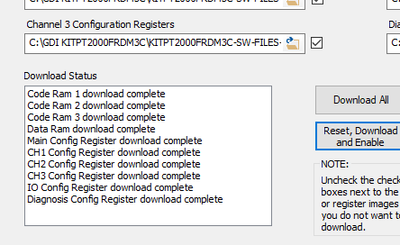

rmaier
Jose,
I tried that as well. I followed the documentation as well as I could. Not everything is clear or correct. I didn't find any "Injector Demo Files" directory per the instructions, so I had to search the files I downloaded manually for the same names. I followed section 5.3 and 5.4 line by line. The microcode is shown (per SPIGen) to be successfully flashed. I see SPI stream via scope as well when sending micro code.
Robert

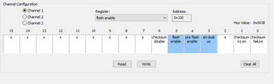

From our Applications team:
You need to read the flash enable register for all channels and see if the following bits are set and that there are no checksum failures.
The register read values should look like this:
Since the boost converter is not working there could be an error on that channel. There will also not be enough voltage to actuate the injector.
Jose

rmaier
Hello Jose,
This appears to be the issue. Here is what I see for each channel after reading SPI:
I do not get any failure message while downloading the micro code. Is there something I can do to fix this?
Robert Maier
11,817 Views
reyes
I discussed with the Apps team and they told me that most likely, sense since all 3 channels have a checksum failure, you have an old part with a different key as the one coming with the IDE.
