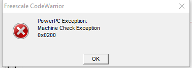

I have found the reason that cause this Machine Check exception, and it is in the Interrupt processing function, after restoring the GPR13(which refer to r13 in the source file), when the program reaches a global variation, the codewarrior would send out the exception.
So then, I found a new project in the codewarrior(ver 8.8), and find the file eppc_exception.asm which contains the Interrupt vectors. And I find that the GPRs are saved and restored from r3 to r12, not include r13-r31. I have know that r14-r31 is used to contain the temporary variations. The r13 is used for What? And how could restoring the r13 cause the Machine check exception?

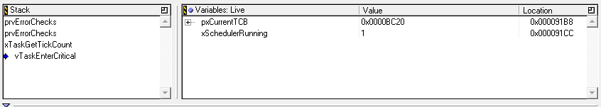

I got the Exception 0x0200 while debugging with USBTAP.
The variables before the exception appears is like this:
Step one more line, the exception occurs.

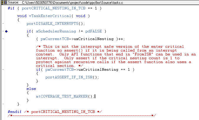

the source file stop at the following line when the exception occurs.
How should the exception appears at here?
