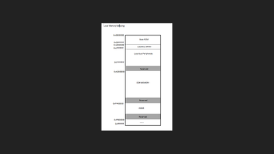

Hi Folks
We are using MPC8358E processor and we configured the local memory as shown in the fig.. mainly we are struggling with DDR interface. so please confirm this memory mapping.
is this DDR memory mapping is right?
Venkat

ufedor
Proposed memory map is incorrect.
Please read the MPC8360E PowerQUICC II Pro Integrated Communications Processor Family Reference Manual, 5.2 Local Memory Map Overview and Example
17,693 Views

ufedor
What is the DDR SDRAM size?
17,683 Views
venkat1
DDR size-64MB
Manfr- micron
17,675 Views
ufedor
What are RCWLR and RCWHR values?

ufedor
Please provide:
1) DDR SDRAM connection schematics as searchable PDF
2) what is measured frequency of the MCK?
17,605 Views
