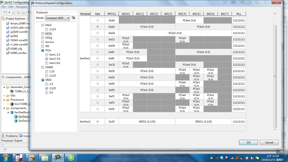

Hello, I have a problem here. The SerDes PLL of T2080 is not locked occasionally, which is more obvious at low temperature. Please give me some advice,thanks!Attached is my RCW。
In addition, can T2080's SerDes protocol mode be configured as AA and 2D? I've tried this mode and it seems to work。

Please refer to the NOTE from the previous answer - the SerDes protocols combination 0xAA 0x29 is not supported.

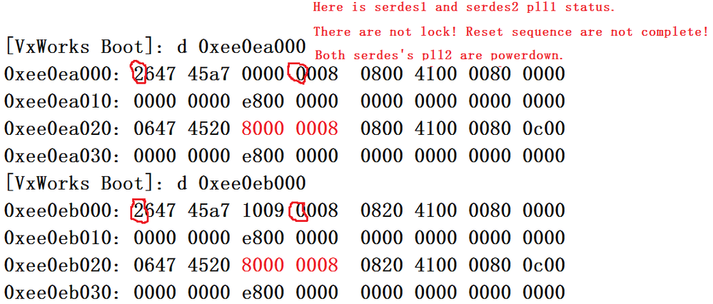

Those two PLLs have been turned off, but the problem still exists。pastedImage_1.png

ufedor
Please provide new RCW binary image.
What exactly does it mean?
1) Please confirm that SerDes PLL reference clocks are stable before PORESET_B is deasserted.
2) Please provide a digital scope traces of the SerDes reference clocks at the processor's pins to check amplitude.
3) Please check that all supply voltages are within the processor's Data Sheet requirements.
5,262 Views

hello ufedor,the SerDes protocols combination 0xAA 0x29 can be found in codewarrior。And t2080 ce recommends that mode AB can be replaced by AA。pastedImage_1.png
This configuration is not supported - refer to the QorIQ T2080 Reference Manual, 19.1.1.1.1 SerDes Protocols (SerDes 1 and SerDes 2):
"NOTE
The table below lists the SerDes protocol SRDS_PRTCL_S1 and SRDS_PRTCL_S2 combinations supported. When selecting protocols from the table below, there is a restriction to choose the supported protocol combinations by line (SerDes 1 and SerDes 2 together), for example SRDS_PRCTL_S1= A2 can ONLY be combined with SRDS_PRTCL_S2= 16"
