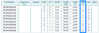

Please make sure you have chosen the FS65 type with the CAN interface. Please refer to the Table 1. and Table 2. in the FS6500-FS4500 datasheet attached.
