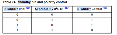

① In this case, I am considering fixing the STANDBY(4PIN) of PF3000 to Low at all times, and controlling PWRON(48PIN) to High/Low to turn the power On/Off. Is this understanding correct?

① In this case, I am considering fixing the STANDBY(4PIN) of PF3000 to Low at all times, and controlling PWRON(48PIN) to High/Low to turn the power On/Off. Is this understanding correct? [gw]You can configure PMIC on active standby mode by below picture:

① I didn't see a diagram. Could you please provide one?
