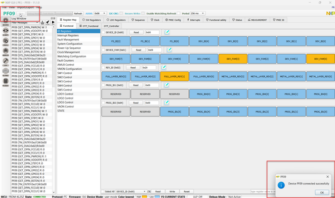

I have now soldered on the headers. However, nothing happens when I try to connect the kit using the NXP_GUI. I also found an old kit for the PF8100 with an older FRDM-KL25Z; that one is detected. What could be wrong?
307件の閲覧回数
d_j
Contributor V
Perhaps I bricked the firmware. Can you tell me if this the correct firmware: OpenSDA/PEMicro/2016-02-08/MSD-DEBUG-FRDM-KL25Z_Pemicro_v118.SDA at master · savoca/OpenSDA · GitHub
...or can you give me the link to the correct firmware?

I’m still surprised that it’s supposed to fit. The outline is different, and connector J21 interferes with the board. Should I desolder it?
Shouldn't the controller board look more like this?
21件の閲覧回数
ErikaC
Please solder female headers onto the KL25 side.
335件の閲覧回数
d_j
Contributor V
Okay, I’ve thought about it again. J21 is probably just a jumper and won't interfere with the top board if the pin headers are installed. I'll give it a try.
