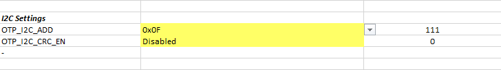

Hi there,
I was currently checking the OTP programming of two differently programmed PF8100 with NXPs programming board
and the FlexGUI Tool.
Reading the registers of the first PMIC works like a charm (I2C address 0x08).
But the second one can't be read out, since we programmed an I2C address of 0x0F
and the FlexGUI only allows addresses until 0x0d.
Is there any workaround?
Simon

Hi Simon,
You are right, there are missing  options for 0x0E and 0x0F in kit interface definition for all PF8x variants.
I sent a request to the applications team in charge of the FlexGUI tool to update the tool, they told me that they will work on this issue and upload a new version of the tool with this issue corrected.
This correction will be applied this or next week.
Jose
