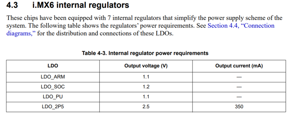

I'd like to get your advises about internal regulators requirement.
I found below table on Hardware Development Guide for i.MX 6DualPlus/6QuadPlus, 6Dual/6Quad and i.MX 6Solo/6DualLite Applications Processors,
what is the meaning of this output voltage? This means minimum, or typical?
And, this power requirement for which series of I.MX6? Quad?Dual Lite? ,or the others?
Actually, what this table want to describe?

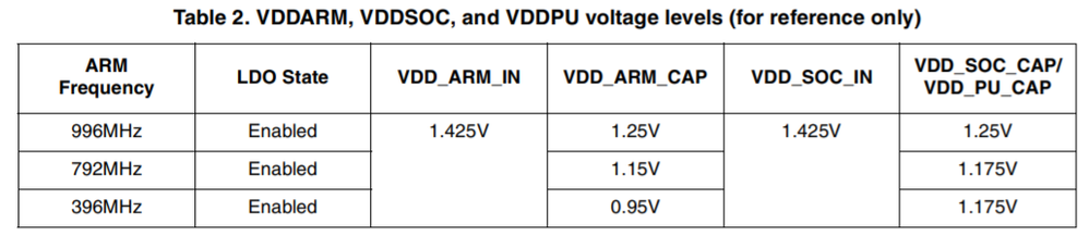

I found below table at page.7 on AN4576.

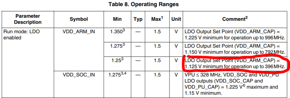

VDD_ARM_CAP voltage at 396MHz is 0.95V, but I think that is not satisfied with below operating ranges described on datasheet.
VDD_ARM_CAP=1.125V minimum
Could you teach me the detail about VDD_ARM_CAP requirement?
Br,
Yuji
2,408 Views
Yuri
   Use specifications of the recent (i.MX 6 S/DL) Datasheet(s). The data of the app note
are obsolete.
Yuri.

Yuri
  The mentioned table provides some nominal values for reference.
Refer to i.MX6 Datasheets and RMs for more details regarding the LDOs.
