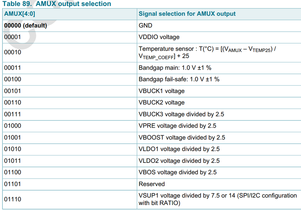

Hi NXP team,
    For FS84,Can I read Main OTP_REGISTERS data?If it can be read, please tell me how.Thanks!

liubenjun
Isn't the regulator configured by OTP?Are these voltages related to the Main OTP_REGISTERS configuration?

liubenjun
Okay,Thank you for your reply,I have another question,I read some voltage values from the M_AMUX register as follows: VDDIO voltage = 3.23V, VBUCK1 voltage = 1.25V, VBUCK3 voltage = 2.32V, VPRE voltage = 3.29V, VBOOST voltage = 5.78V, etc. How do I know these voltage values are correct.
