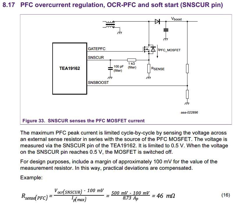

Two possible causes are:
OCP
PFC OCP function can be limiting the output power.
  1. Measurement resistor value to high
  2. Too much disturbance on SNSCUR
A quick first trial is to reduce the resistor value by 2 by adding another resistor in parallel and observe if it solves the limiting problem.

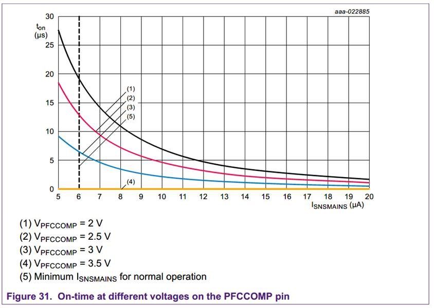

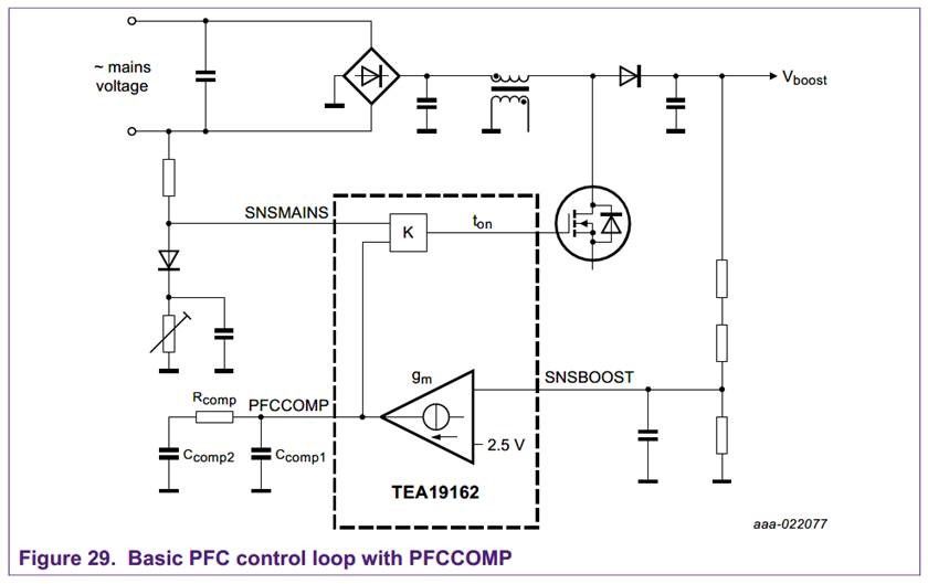

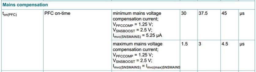

Maximum on-time
The PFC controller regulates the power by means of on-time control. The maximum on-time can be limiting the power.
  1. The maximum on-time is as expected, but the PFC coil impedance is too high to make sufficient power (current amplitude in this time).
  2. The maximum on-time is shorter than expected. This can be caused by a problem in the mains voltage measurement that results in a too low (maximum) on-time. The maximum on-time is depending on the mains value:
Measuring the PFCCOMP voltage helps to understand what the situation is.

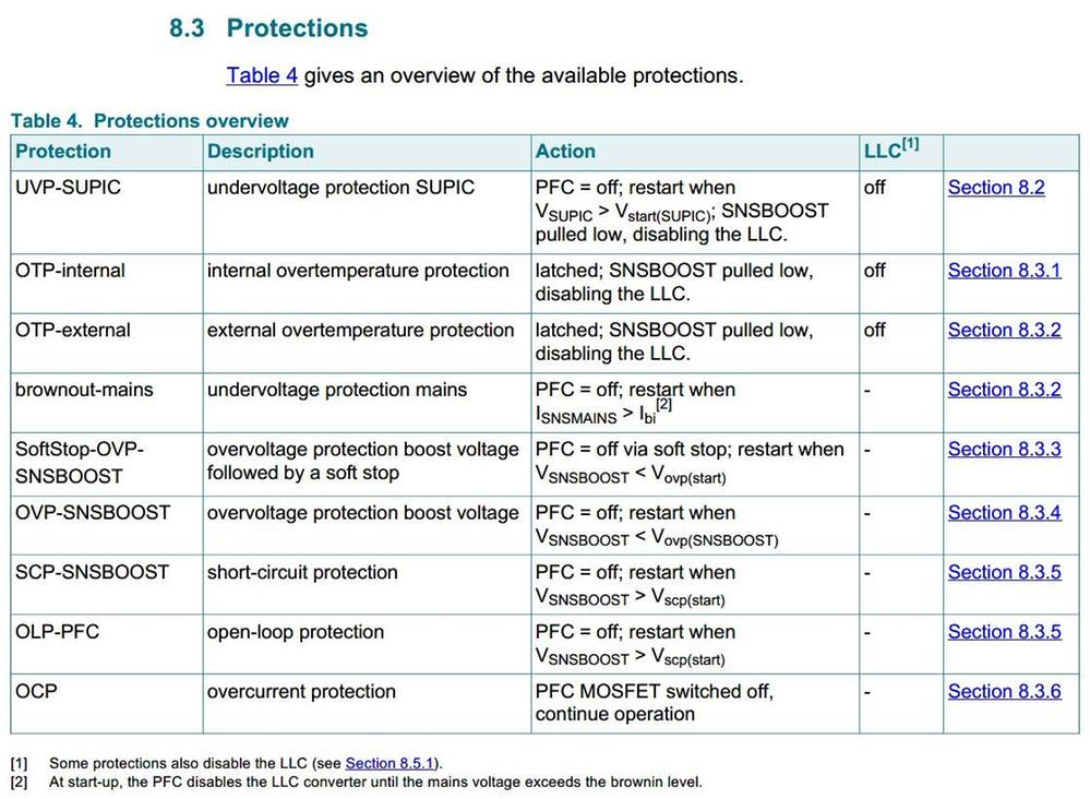

2. Even before the LLC gets into problems, so at higher AC voltages or lower loads, I see inexplicable PFC behavior, namely that it stops switching during 170 to 450uS during the rising 100Hz half-sine wave. This happens when the PFC reaches the maximum frequency. I have added some pictures of the MOSFET drain voltage.  This pause in PFC operation is in my opinion the reason for lack of PFC power transfer.

TomasVaverka
Hi Jan,
Thanks for including some scope measurements of the behavior. This behavior does not directly look familiar.
It is indeed not related to a possible issue on OCP or on-time. It also does not look like regulation instability.
It looks like a protection is interrupting the behavior for a short time.
This is the list of protections to check:
The interruption is too short for SNSMAINS brownout/in hiccup.
It is not likely that OVP SNSBOOST is triggered because it happens when the boost voltage is lower.
Good to check the SUPIC voltage. It is probably generated by an aux winding on the LLC (which is not working well at low Vboost voltage).
Just a remark: maybe it is intended, but the boost voltage seems rather low for operation. Usually (universal mains) systems use a nominal boost voltage between 380V and 400V.
Tomas

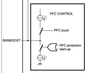

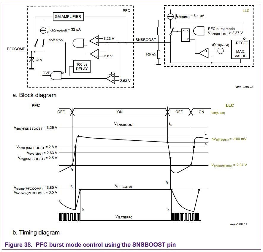

TomasVaverka
Hi Jan,
I assume that the TEA19162 PFC controller is used in combination with the TEA19161 LLC controller (as intended).
It seems that the TEA19161 controller increases the SNSBOOST voltage for Burst Mode operation (while this was not intended; something may be wrong in the LLC).
Although the levels do not really match the intended SNSBOOST voltage levels (in diagram below); the PFC stops and the SNSBOOST is pulled high.

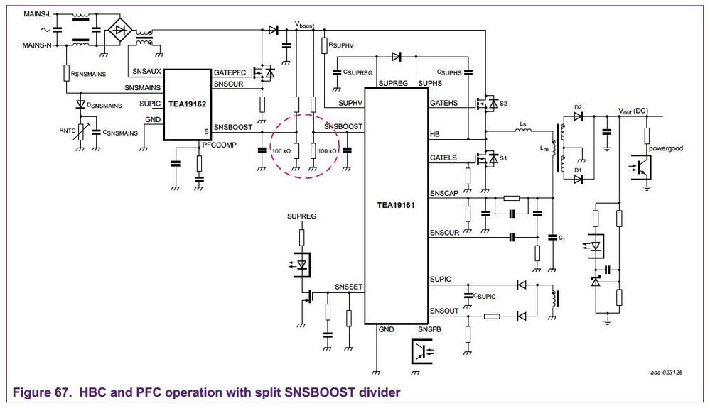

For a more easy debugging you can temporarily split the SNSBOOST functions to see a more independent behavior of the converters. Now the LLC controller cannot influence the PFC operation anymore:

janhoc
I did the split of the SNSBOOST divider.
With this the PFC works as expected. The VBOOST voltage remains constant over the full AC input range, even at full load.
With the split, I also no longer see the voltage increase on SNSBOOST, the signal remains clean at both ends of the split.
So it is definitely the HBC disturbing the PFC through the SNSBOOST link that is causing the problem, but it remains a mystery what cause could be, especially since there is a strong correlation with the AC waveform.  The only potential cause I see is the ripple on VBOOST that causes the LLC to start some form of protection.
Any suggestions on other experiments?

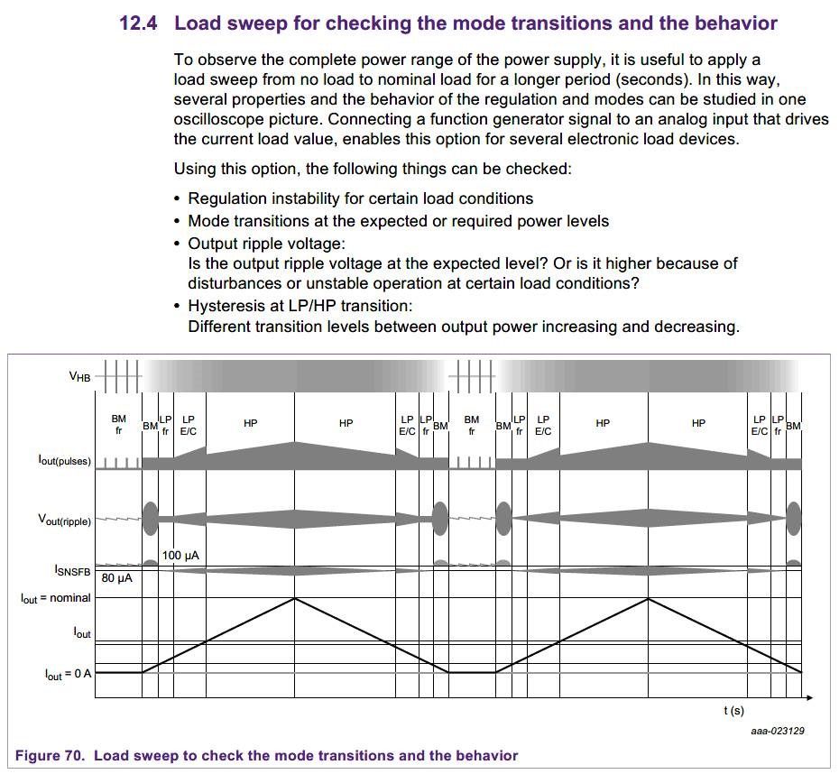

TomasVaverka
Hi Jan,
It is good to first check, debug and optimize the LLC converter, before connecting it to the PFC again (by SNSBOOST).
In the split-up situation, the voltage on the TEA19161 SNSBOOST pin is similar to the situation when both are connected (including ripple). The behavior at several load conditions can be checked for the LLC converter.
A load sweep can provide a good overview of LLC mode transitions:
When entering BM operation, the TEA19161 will pull-up the SNSBOOST pin. Check if the power level for BM is as expected/chosen/designed and that the SNSBOOST lifting only happens in this mode.
When an (unintended) protection is triggered, the LLC controller (TEA19161) will pull-down the SNSBOOST pin.
When mode transitions are not as expected/intended or are unstable at certain power levels, the SNSCAP divider can be checked (AN11801, Chapter 9).
