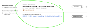

或者下载驱动再看看:
FS6500 | Grade 1 and Grade 0 Safety Power System Basis Chip | NXP Semiconductors
