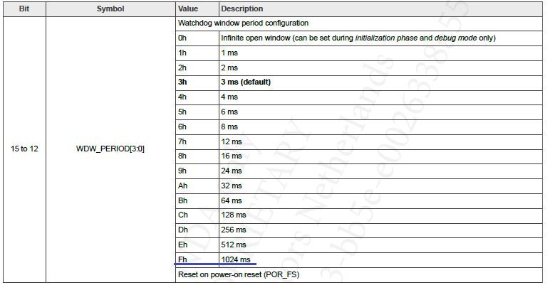

Can I make Sbc Wdg period more than 1024 ms? If I can, could you tell me how can I do it?

TomasVaverka
Hi Emre,
The WD window is configurable using WDW_PERIOD[3:0] bits and the maximum value when not considering an infinite open window is 1024ms.
Tomas
