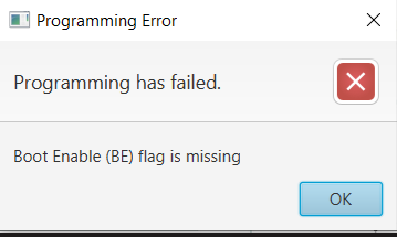

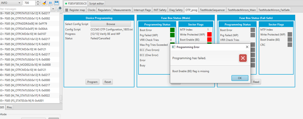

Hi NXP Team,
I am attempting to use KITFS85FRDMEVM to program the FS85 OTP configuration via I2C on my project boards.
I2C is connected through headers VDDI2C, SDA, SCL and GND.
For my setup I am providing 8V at the DBG pin in line with the evaluation methodology.
I am able to load my OTP script and verify the correct functionality on my PCB, though when I attempt to burn the OTP configuration files to memory I get Boot Enable flag error and programming does not succeed.
I tried a reboot to see if the configuration burned anyway, though the device operates in default state post this process.
I have viewed other threads which talk about issues with A1 variants where the memory was already burned, however I know this is not the case for these as the operation returns to default.
Any help would be much appreciated.

Looking at your manual, everything works out, we can change the FS85xx config (like seeing definite change as our desired voltages are generated).
However, when actually trying to burn the OTP, a error occurs:
Can you give us a hint what this flag is? We cannot find anything in the documentation about it.

Before do the OTP ,did you use this OTP script to verify  under OTP emulation mode?
6,551 Views
Sebastian_etelligent
Yes, we created a script (.txt) via the excel document and our adjustments and emulated it succesfully in the GUI and board. Everything seems to be in order there, but the actual OTP programming failes everytime.
6,431 Views
We were now able to write the OTP. It seems, that our first SBC we tried had a defect, since it worked with a second sample and the same configurations.
