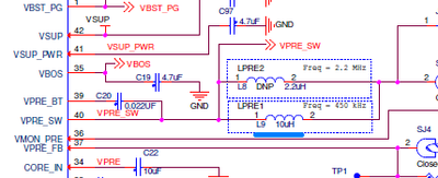

While reading through the FS26 Datasheet 4.0 document, I noticed a discrepancy regarding the LVPRE in Figures 78 and 79. These figures indicate the usage of a 1.0uH inductor, whereas Table 161 in the document specifies 10uH. Could you please clarify which value is correct?
Additionally, there seems to be inconsistency regarding the LVPRE_DCR_450kHz specification. Table 161 lists it as 75mΩ, whereas Table 160 mentions RDCR_LPRE as 60mΩ. Could you please confirm which value is accurate?
Thank you.

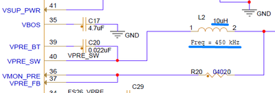

Hello IHSIANG,
I have checked older FS26 datasheet revisions (2.0, 2.2 and 3.0) and in all the LVPRE value for 455kHz is 10uH. Also in an EVB schematics 10uH is used. I apologize for this and I have reported this typo to a responsible team.
As for the RDCR value, in our KITFS26AEEVM and S32K3X4EVB-T172 EVBs, XAL5050-103ME inductor with RDCR 41 to 45mOhm is used.
So you can go with the lower 60mOhm value.
