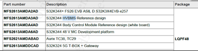

guoweisun
For the S32K344,you can select FS26 from below list:

patricklanglois
With no intent of disrespect, as you repeat your answer, I suppose that I must repeat my question following it...
I don't see the MR-CANHUBK344 evaluation board in your list. Is there a mistake here?
But at the end, what I want to know from my initial statement is simply:
What is the production part number for the FS26 SBC to specifically replace the one on the MR-CANHUBK344 evaluation board? Your list specifies other evaluation boards, not this one that we purchased. And, the schematics of this board are still pointing a preliminary part, while a production part probably exists now. Are all the components in your list a fit to replace the one on my evaluation board and to supply the S32K3? I want to identify the right variation of the FS26 SBC to properly analyze the evaluation board design.

guoweisun
I compared your EVB FS26 regulator output sequence and Vout, there is no suitable FS26 OTP part for recommend, they are not match/different.
So you can try to buy A0 blank part and do OTP by yourself with the OTP socket board.

patricklanglois
I don't see the MR-CANHUBK344 evaluation board in this list. Is there a mistake? This list looks like an excerpt of a more complete document. Would you please provide the reference to the document where I can find the complete list if this one includes the evaluation board I mentioned here?

guoweisun
This EVB used this MCU:

guoweisun
Fort FS26 selection please refer to below:
