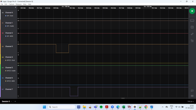

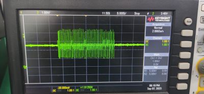

We are working with MC33771C for our BMS and using MC33664 for TPL transceiver.
As per the datasheet of MC336644, I understood that RX CSB will be made low by the transceiver once the Start of Message is received by the transceiver.

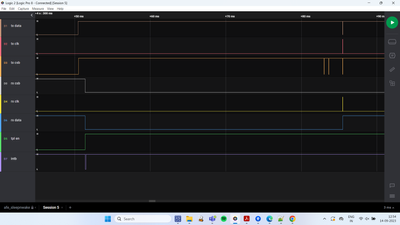

We are seeing message frame on the TPL lines but no messages are seen on the RX of the transceiver. Also, the RX CSB is also not getting low.
Attachment Details

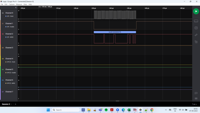

1) Image of Oscilloscope capturing the message frame over TPL RDTX+
2) Screenshot of Logic analyzer traces
ch 0 - TX clk(MCU is master),
ch 1 - TX CSB(MCU is master),
ch 2 - TX DATA(MCU is master),
ch 3 - TPL EN (from MCU),
ch 4 - RX clk(MC33664 is master, MCU is slave),
ch 5 - RX CSB(MC33664 is master, MCU is slave),
ch 6 - RX DATA(MC33664 is master, MCU is slave),
ch 7 - INTB(from MC33664)
How can this issue be debugged?

Hello Dinesh,
please share your schematic with voltage levels and part values. Please disconnect the RX CLK, RX CSB,
RX DATA pins of the MC33664 from the MCU and measure it then with the logic analyzer.

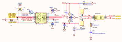

dinesh_balaji
 This is the transceiver section of the schematic.
Even after disconnecting  RX CLK, RX CSB, RX DATA pins of the MC33664 from the MCU, the behaviour remains the same as mentioned before.
One more doubt, for wake up message/signal I'm seeing both TX and RX CSB going low. But for message transfer I'm not seeing any on RX. Is there something I'm missing? I've checked the GPIO configurations and SPI configuration, all seems to be okay.
The same piece of code works on our different product, TPL and AFE circuit sections are same as this product.

thank you for confirmation. Your schematic is correct. This looks, like the MC33664 piece is faulty. Have you tried to replace the MC33664 with another piece. Best would the to replace it with the one, which you have confirmed it works correctly in the different product. If not, could you please test a new MC33664?

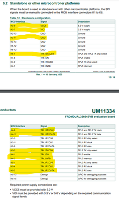

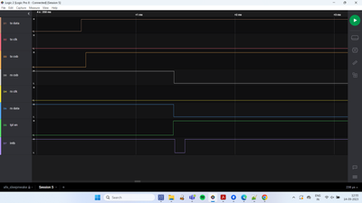

@JozefKozon Thanks for your reply and sorry for the delay in my response.
I tried the same thing with s32k144 eval board and FRDMDUAL33664EVB eval board.
Now the issue seen is just after enabling the transceiver the RX CSB is pulled low throughout. So the MCU is stuck in receive interrupt.
As per the datasheet the RX CSB should be made low only when SOM frame is present on the TPL line.
But here the RX CSB is pulled low just after enabling TPL transceiver.
Logic analyzer traces are attached showing this issue.
Pins used on the transceiver eval board are highlighted in one of the images attached.

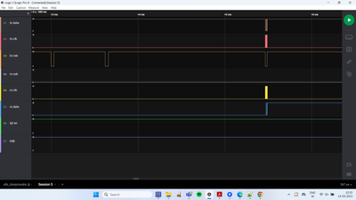

dinesh_balaji
Actually, assigning of CID will take place only after soft reset of the AFEs.
Because of this problem(of TPL RX) faced we're not able to reach assigning of CID stage.
I'll show you the logic analyzer traces from one of our working products.
In this trace I want to highlight that when Wake sequence is sent i.e. TX CSB low for 25us and high for 600us and low for another 25us, in TPL line it'll be SOM for the falling edge in the low pulse and EOM for the rising edge in the low pulse, so this will translate to 2 SOM and EOM frames in the TPL line. This can be viewed on RX CSB also.
But this behaviour is not seen in the logs I shared you before, this means that TPL transceiver is not identifying the frames in TPL line, that's why the CSB RX is either low always after enabling transceiver or it is high always.
