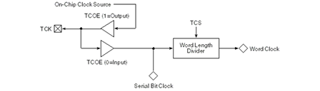

P1010 and P1020 are different devices, with different silicon inside, so TDM function is not guaranteed to be identical.
For P1010: This is a copy of Figure 23-7 from P1010 Reference Manual:
You can see “On-Chip Clock Source” and gate controller by TCOE bit (this bit is in TDM_SB_TDMTIR register, see Section 23.5.3)
Now similar Figure from P1020 Manual – Figure 19-37:
No “On-Chip Clock Source” path and no TCOE bit. The same in TDM_SB_TDMTIR register – bit 22 is reserved.
So – yes, P1020 TDM block is different in regards to internal clock, according to P1020 Reference Manual.

if (tdm_internal_clk) {
//out_be32(&priv->tdm_regs->rir,
// RIR_RFWM(RIR_RFWM_VAL) | RIR_RFEN | RIR_RWEN | RIR_RDMA |
// RIR_RSO | RIR_RCOE | RIR_RRDO | RIR_RFSD(RIR_RFSD_VAL));
//out_be32(&priv->tdm_regs->tir,
// TIR_TFWM(TIR_RFWM_VAL) | TIR_TFEN | TIR_TWEN | TIR_TDMA |
// TIR_TCOE | TIR_TSL | TIR_TSO | TIR_TRDO |
// TIR_TFSD(TIR_RFSD_VAL));
RIR_RFWM(RIR_RFWM_VAL) | RIR_RFEN | RIR_RWEN | RIR_RSO | RIR_RCOE |
RIR_RDMA | RIR_RFSD(RIR_RFSD_VAL) | RIR_RRDO);
TIR_TFWM(TIR_RFWM_VAL) | TIR_TFEN | TIR_TWEN | TIR_TSO | TIR_TCOE |
TIR_TDMA | TIR_TFSD(TIR_RFSD_VAL) | TIR_TRDO);
out_be32(&priv->clk_regs->tx, TDM_CLK_DIV_VAL);
out_be32(&priv->clk_regs->rx, TDM_CLK_DIV_VAL);
pr_info("TDM configured to use internal clock");
} else {
Rx Water mark 0, FIFO enable, Wide fifo, DMA enable for RX,
Receive Sync out, syncwidth = ch width, Rx clk out,zero sync,
falling edge , data order
RIR_RSL | RIR_RSO | RIR_RCOE | RIR_RRDO |
TIR_TSL | TIR_TSO | TIR_TRDO | TIR_TFSD(TIR_RFSD_VAL));
pr_info("TDM configured to use external clock");
