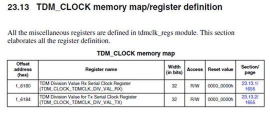

We looked at the Ref Manuals of P1020, P1010 and T1040. There is a section of TDM Clock control <see snips below, It is there in P1010RM and T1040RM but NOT in P1020RM
So a question to understand the customer requirement better:
What is the customer looking for? I mean will they be using this in their product as a feature? Or it is being used by them for some validation purpose?
Meanwhile we are looking for some person in design team to check if these registers are there in P1020 or not.And also try to get the validation/verification status of this feature.

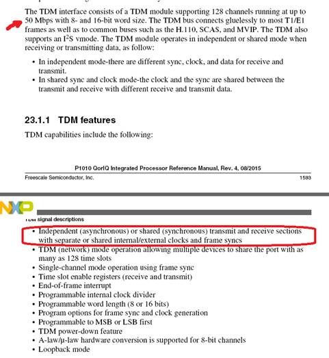

49,543 Views
naumgrutman
Hello Yipping
Please find answers to yours and/or AE’s questions:
->  We are in the process of building a product that is gonna be very much
depending on P1020’s TDM and its abilities and capabilities…
->  Yes, we will be using TDM in our product extensively
and need for P1020 to produce 10Mbps clock on the TDM
It clearly states that 50Mbps should be handled…
We are just looking for 1/5 of that 10Mbps
->  Obviously, currently we are trying to validate above
that is why we are using the P1020RDB product and are looking for
TDM_LOOPBACK_TEST to PASS using Internal clock
And also want Internal clock configured correctly
to produce 10Mbps bit clock on the TDM
I have provided excerpts for P1020 and P1010 Reference manuals
Obviously you can see that they offer same TDM features.
We definitely want all the TDM features listed on P1020
and have TDM validated via TDM_LOOPBACK_TEST
using internal clock configured to produce 10Mbps

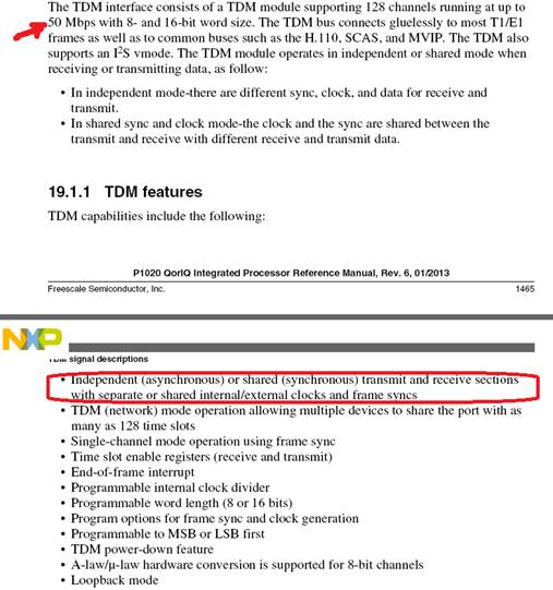

49,498 Views
yipingwang
Hello Naum Grutman,
Please refer to the following information which I got from our hardware team.
P1010 and P1020 are different devices, with different silicon inside, so TDM function is not guaranteed to be identical.
For P1010: This is a copy of Figure 23-7 from P1010 Reference Manual:
You can see “On-Chip Clock Source” and gate controller by TCOE bit (this bit is in TDM_SB_TDMTIR register, see Section 23.5.3)
Now similar Figure from P1020 Manual – Figure 19-37:
No “On-Chip Clock Source” path and no TCOE bit. The same in TDM_SB_TDMTIR register – bit 22 is reserved.
So – yes, P1020 TDM block is different in regards to internal clock, according to P1020 Reference Manual.
