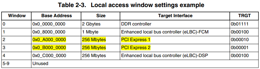

hello all ,
     env: vxworks, p1020rdb.
     the target.ref show as follows:
      PCI-E-HOST:0       | on-chip    |                     | UNSUPPORTED
      PCI-E-HOST:1       | on-chip    | m85xxPci.c          | SUPPORTED
     0x9000_0000 | 64MB  | 0x93FF_FFFF | PCIe-2 Memory
     0x9400_0000 | 64MB  | 0x97FF_FFFF | PCIe 2 Non-Prefetchable Memory
     0x9800_0000 | 64MB  | 0x9BFF_FFFF | PCIe 2 I/O Memory
      2 questions as follows:
     1) if i want to use the 2 pcie interface, the host controller of PCIE-HOST0  is the same as m85xxPci.c   ?
         i just need to modify the hwconf.c, syslib.c,and  p1020rdb.h ?
     2) in the p1020RM.pdf,
          the  base address of pcie2  canbe set as 0x9000_00000?
          the base  address of pcie1 canbe set as 0xa000_00000?
          i am confused, thanks for all reply.

i understand the meaning. no issue.
