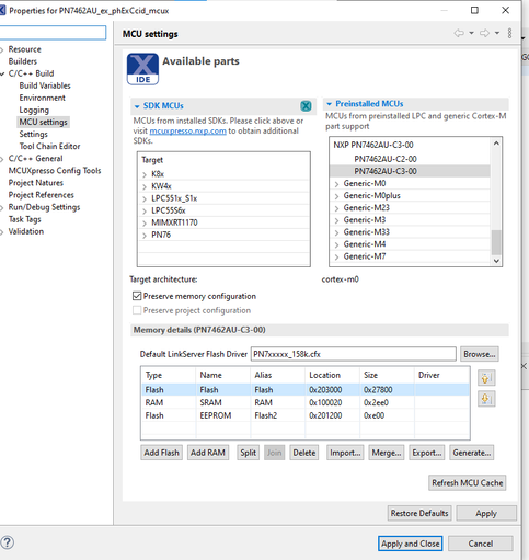

Hi, I'm new in NXP and I have a problem with uploading the example to the board.
I have a PNEV7462C dev board and want to upload phExCcid example using a J-Link or a divece as a mass storage. I've upload support packege and open the example with MCUXpress IDE, if I run the debug - the device works fine, but if I want to upload with RUN after uploading nothing works. Also I've tried with mass storage, upload EEPROM file separetly and bin file that was creating while building and nothing works.

I succesfuly open the needed project, but the problem is that the example works only in debug mode. When I use program flash or uploading using mass storage nothing works

Just checked the properties of this project, it programmed into flash.  it should work without debug.  But no print on debug console.

This demo works without debugger,  but you can not see the debug output in MCUXpresso console, since you stopped debugging.   actually it works
