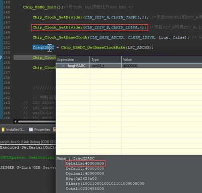

Habib_MS
Hello @uaShark,
I have successfully configured the HSADC to operate at 40 MHz by setting the divider to 6, as illustrated in the image below:
In order to support you better, could you please share how you are calculating the sampling rate on your end?
Habib

uaShark
Hello, @Habib_MS
Actually, I also successfully configured freqHSADC=80MHz by setting the frequency divider to 3. This value is configured correctly. I also configured DGEC=0xE and CRS=0x4 according to the user manual, but the actual sampling rate doesn't match this value.
Here's how I calculated the sampling rate: During actual measurements, I input a square wave signal with a period of 25us to the HSADC and found that only 850 samples were collected in 25us, giving an actual sampling rate of 34MHz, which doesn't match the freqHSADC setting.
Additionally, I have a question: the current actual sampling rate was achieved after I configured PACKED_READ=1. Before this configuration, the actual sampling rate was only 17MHz. Is it reasonable that this configuration doubles the sampling rate? I'm not sure about this.
Looking forward to your reply!
