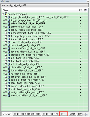

      ADC demo default path is:
      ..\lpcopen_2_19_keil_iar_keil_mcb_4357\applications\lpc18xx_43xx\iar\keil_mcb_4357\periph_example.eww
     LPCOpen software [periph_example.eww] project provides LPC4357 most modules driver application demos.
The ADC demo need precompile MCB4357 board support package (lib_lpc_board_keil_mcb_4357) and LPC43xx chip driver (lib_lpc_chip_43xx). MCB4357 board support package provides MCB4357 board related pins configuration, clock configuration, on-board external memory configuration, Ethernet PHY driver configuration and board hardware resource configuration; LPC43xx chip driver provides LPC43xx modules driver API function.

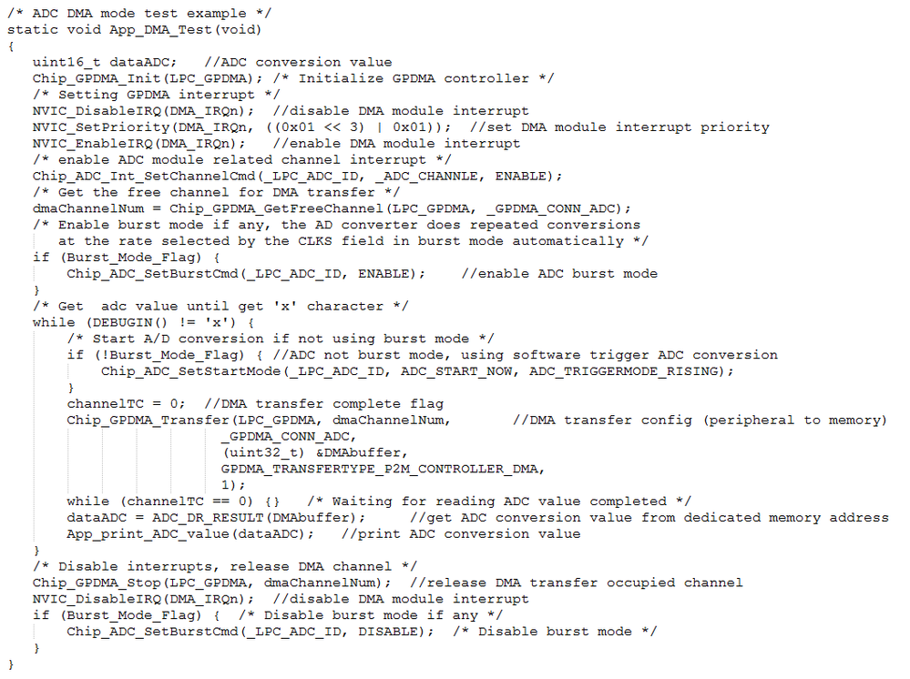

      ADC demo provides three modes to get ADC conversion value: polling mode, interrupt mode and DMA mode. The demo config 10-bit ADC module with 400K Samples/s and ARM Cortex-M4 core clock frequency with 204MHz. The test uses Timer0 module as time-base and counter reference clock is same with ARM Cortex-M4 core clock frequency (204MHz).

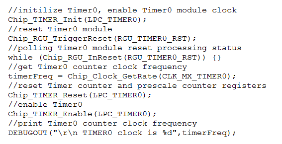

Timer0 initialization code comments:

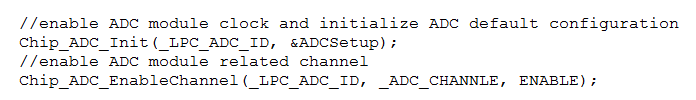

ADC module initialization code comments:

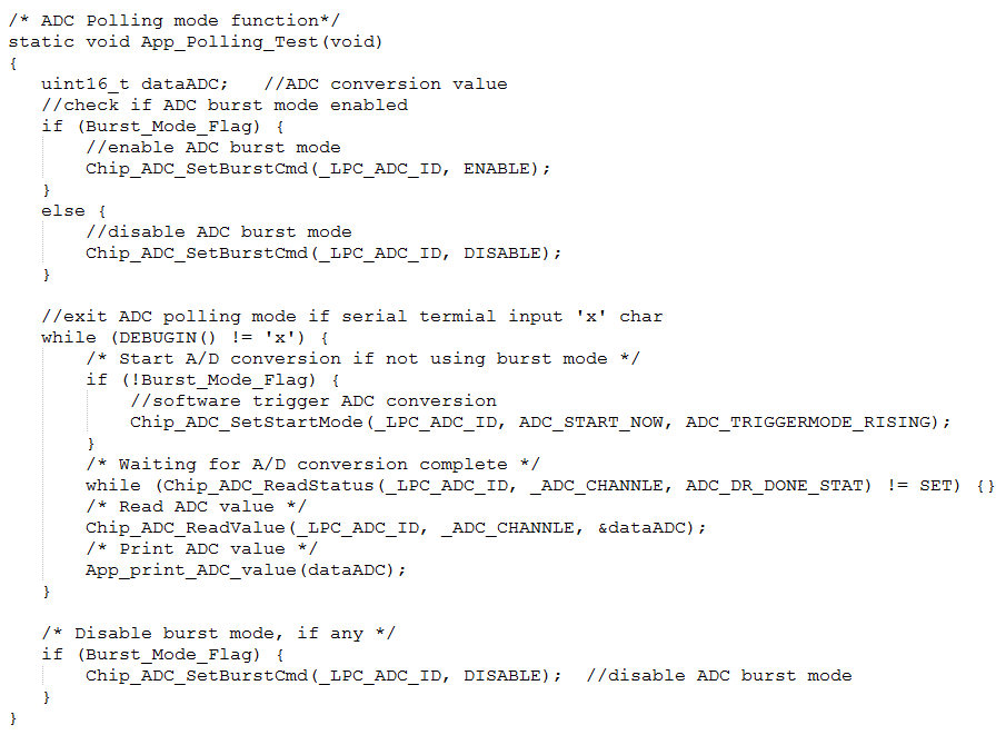

ADC polling mode code comments:

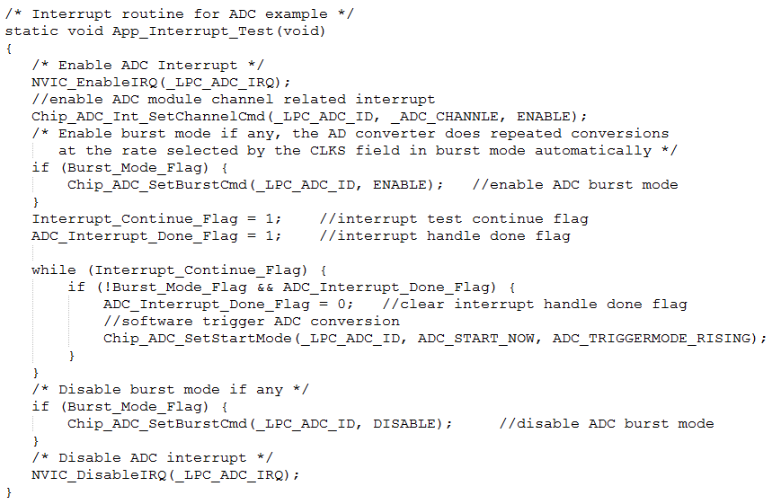

ADC interrupt mode code comments:
ADC DMA mode code comments:

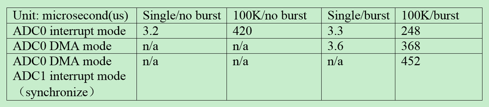

  • Test result
    The test will use TIMER0 counter to calculate each test item time interval.
    The test includes below test items:
     Single/no burst: ADC convert one time with burst mode disabled
     100K/no burst: ADC convert 100K times with burst mode disabled
     Single/burst: ADC convert one time with burst mode enabled
     100K/burst: ADC convert 100K times with burst mode enabled
