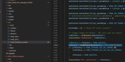

S32R45: There is a lot of time with Calibration,so i want to put the RF Calibration in child thread.Is there anything I should notice?

Yes you could execute the RsdkRfeCalibration() function in a different thread but you need to make sure the calibration operation completes before triggering the start of radar frame.
