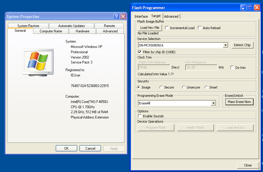

Hi Adriano,
I have installed Win-XP 32-bit in a virtual machine on a Windows 8 machine.
I had trouble installing the drivers and have found the reason for that but I had no problems in installing or running the applications (except for being very slow).
I have been unable to locate a WINXP-64bit VM image.  What version are you running *32/64-bit?
There might also be a problem with language version of windows but I have no real experience with this.
bye

il 12/02/2017 pgo ha scritto:
8,783 Views
pgo
Senior Contributor V
Hi Adriano,
I suspect the problem is an incompatibility with MinGW libraries.  There are some problems with different versions of the windows DLLs.
It is unlikely to be a problem with the XML files since they are unchanged on different OSs.  The files you mention are not valid XML as they are only fragments that are used in other files.
Could you try dependency walker on the Xerces dll and see if indicates missing dependencies?
I will try to locate a Win-XP installation disk and see if I can run it in a virtual machine to see if there are similar errors.
bye
