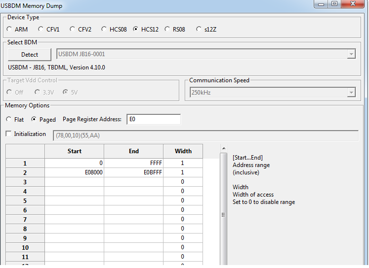

        I have trouble to reading Flash of MC99s12XDT512. And the flash programmer can program from 0x0000 to 0xFFFF.
1,379 Views
alanjiang
Dear PGO,

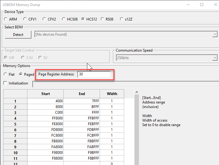

      I found both flash programer and USBDM memory dump have problem to write & read ms9s12xdt512 with JB16xxx. I created a s recode to write 0xE08000 --- 0xE0bfff (e0 Ppage), And then, we tried to read it, and we didn't find the data in s record. It is same 0x8000 ---- 0xBFFF with 0xe08000 --- 0xe0bFFF. So what is problem ? Thanks.
1,379 Views
pgo
Senior Contributor V
To read using the Memory Dump program you need to correctly indicate the PPAGE REGISTER address,
For the MC9S12XDT512 I believe the address is 0x30.
