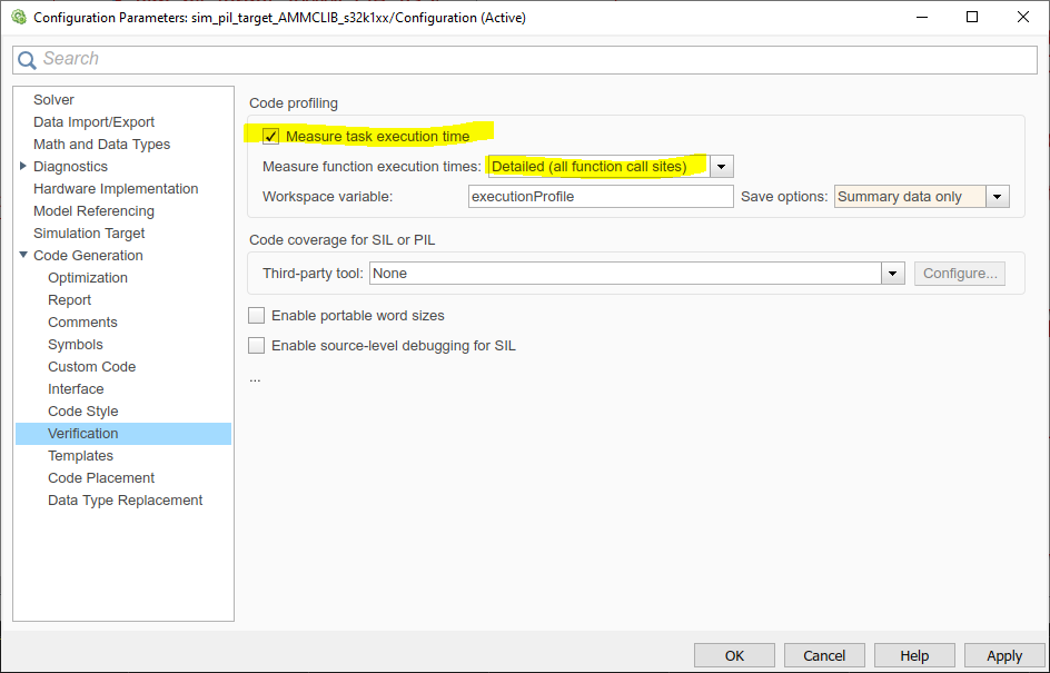

fail on running mbd_s32k_examples PiL model  with Top-level model configuration (Code Generation-> Verification->check Measure task execution time)
and got this build error
if uncheck the measurement, everything is going well
how do I run the PiL model with Measure task execution time??

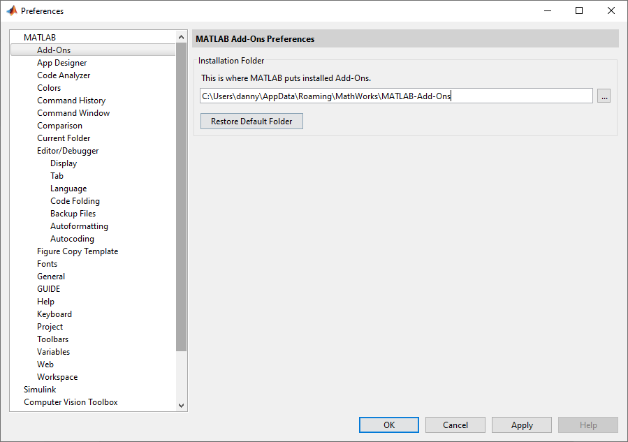

It seems that it doesn't like the space character in MATLAB Add-Ons folder from this path: C:\Users\danny\AppData\Roaming\MathWorks\MATLAB Add-Ons\Toolboxes\NXP_MBDToolbox_S32K1xx\mbdtbx_s32k\src\c_library\gt_pf.c
Can you try the following workaround?
1. Close Matlab
2. Rename C:\Users\danny\AppData\Roaming\MathWorks\MATLAB Add-Ons folder to C:\Users\danny\AppData\Roaming\MathWorks\MATLAB-Add-Ons
Notice that I changed MATLAB Add-Ons folder to MATLAB-Add-Ons.

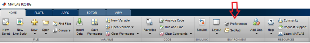

3. Open Matlab and go to the Preferences dialog.
4. Change the Matlab Add-Ons folder to C:\Users\danny\AppData\Roaming\MathWorks\MATLAB-Add-Ons
5. Restart Matlab.

First of all, there is a thing that must be known for Simulink, starting with the latest versions. For the referenced models in order to open the actual referenced model, you have to press on the left side icon. Otherwise on double click the reference model you will only open its content but all the setting will be performed only on the top model.

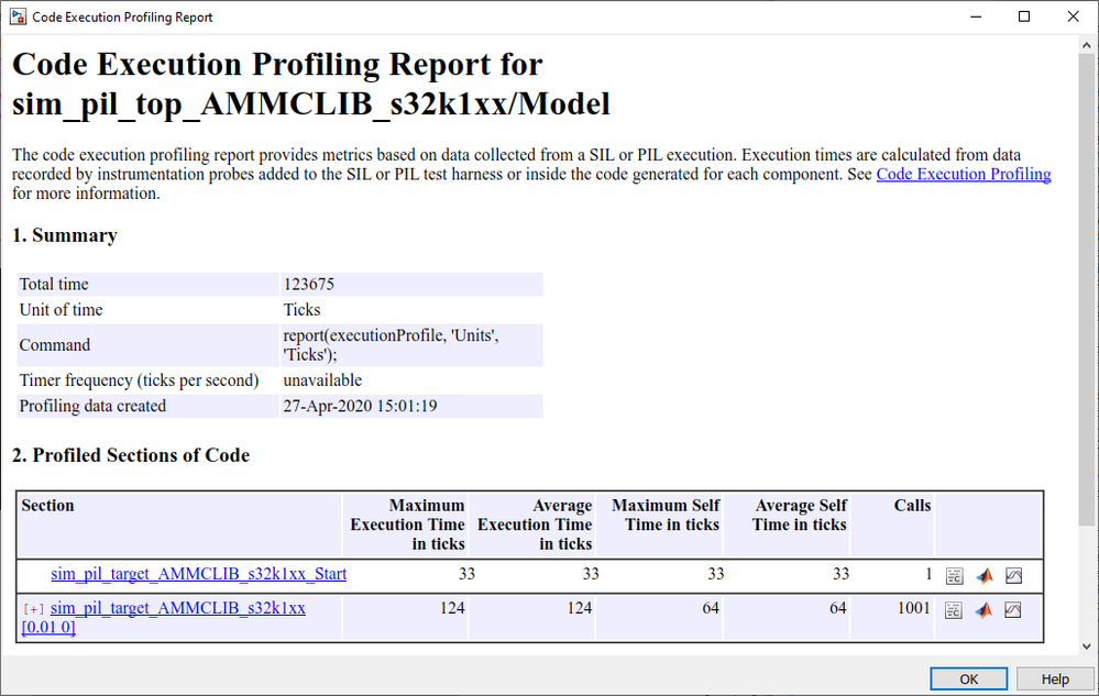

Now, there are two ways of getting the profiler in PIL:
1. Enabling the Simulink verification for the top and the referenced models: but this has to be done for both top and the referenced models! You can update the Detailed execution time. But you need to quit using the profiler blocks.
And the results will be similar to this:

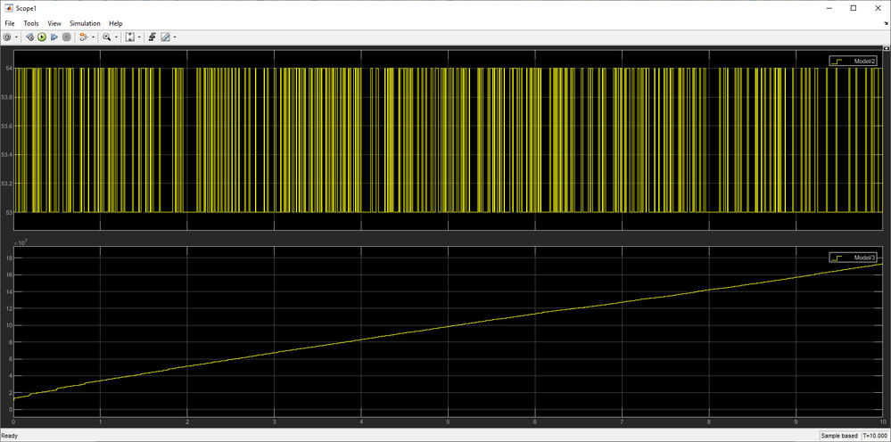

2. You disable the Measure task execution time and use the profile blocks:
Now there two types:  Profile function - (yellow) which adds code at the beginning and at the end of the function and measures the ticks between them. or the Get current bus tick number which basically returns the current bus tick count.
If you will put the output values on a scope you will get the following results:
