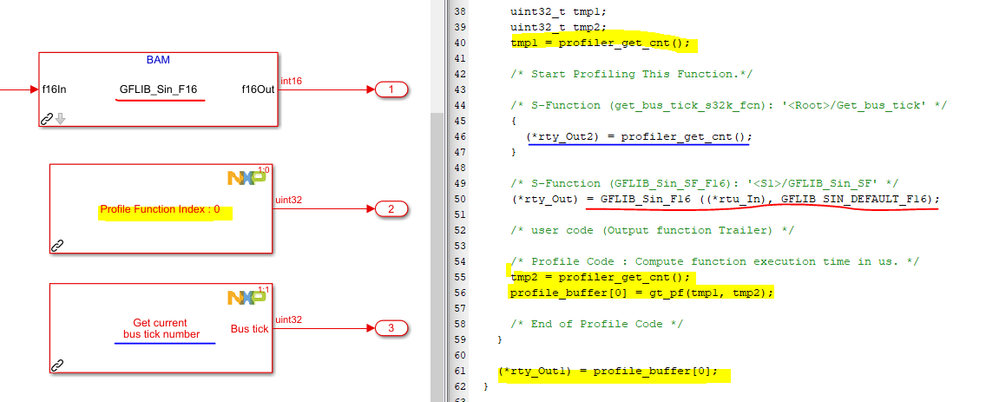

Now, there are two ways of getting the profiler in PIL:
1. Enabling the Simulink verification for the top and the referenced models: but this has to be done for both top and the referenced models! You can update the Detailed execution time. But you need to quit using the profiler blocks.
And the results will be similar to this:
2. You disable the Measure task execution time and use the profile blocks:
Now there two types:  Profile function - (yellow) which adds code at the beginning and at the end of the function and measures the ticks between them. or the Get current bus tick number which basically returns the current bus tick count.
If you will put the output values on a scope you will get the following results:
Hope this helps,
Marius

liu_madeon
Hi razvanchivu,
thanks your reply,
I only config the Target connection in MBD_S32K14x_Config_Infomation to fit my host, overall is base the example sim_pil_top_AMMCLIB_s32k1xx
otherwise, I refer the topic :
Code Execution Measurement using Profiling Function Block
https://community.nxp.com/message/978038?commentID=978038#comment-978038
add the Profiler block in PiL system
but issue here,
and try to varify the PiL is work with devkit I use the get bus_tick_block, is work perfect
1.does any config suggestion to make profiler block work perfectly?
2.by time consuming with algorithm evaluation demand, is this the suggested solution?
or have any other way to do PiL with s32k144?
thank you
Sincerely,
Madeon Liu
