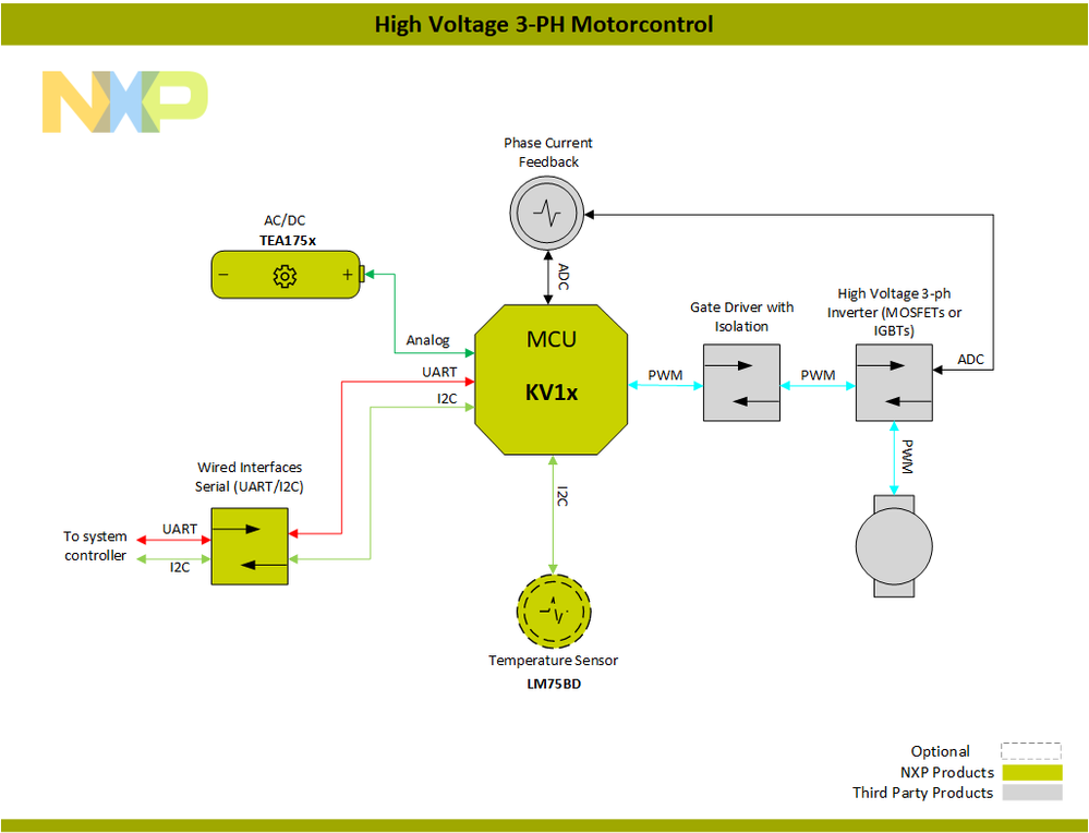

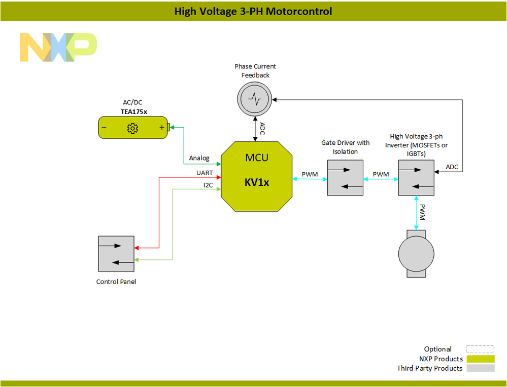

3-phase high voltage motor control can drive today demanding BLDC, PMSM, and ACIM motor control designs with optimized MCU performance. The Kinetis V MCUs range from 75MHz to 240MHz to give product flexibility and to maximize reuse. Additionally, NXP provides a Kinetis motor software suite to reduce the motor control learning curve and accelerate time to market.
Block Diagram
Block_Diagram-High_Voltage_3-PH_Motorcontrol-Drive-Pump[1].pngBlock_Diagram-High_Voltage_3-PH_Motorcontrol-VacuumCleaner[1].png
