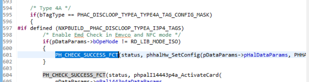

Assuming we're using the phacDiscLoop component:
What's the proper way of using NxpNfcRdLib where even though SAK=0x08 or SAK=0x18,
phacDiscLoop_Sw_Int_ActivateA() is asked to activate the "MIFARE Classic" Looking card as a 14443-4 Type 4A Card?
I can inject my own global variable, to override SAK, but... did I miss a more formal option?
I understand the library may not handle this case because automatically activating 14443-4 would totally mess things up for someone expecting to use Mifare Classic backwards compatibility protocol.

I think the great part about NfcrdlibEx10_MIFAREDESFire is that it targets a SAK which qualifies for RATS/ATS in phacDiscLoop_Sw_Int_ActivateA().
However a Mifare Plus EV1 in SL1 SAK response will not qualify the same way for RATS.
See line 601 of file defining phacDiscLoop_Sw_Int_ActivateA().
What do you think?
Jeff

eljeffo
Kan_LI,
Sorry for intentionally being ambiguous.  I'm not sure how much I'm allowed to discuss NDA items on this public forum.
Referencing your quote above, line 595 prevents a Mifare Plus EV1 SL1 card from running Line 604.
How can I run Line 604 for a Mifare Plus EV1 SL1?
Jeff

eljeffo
Hi Kan,
SL1SL3Mix mode requires treating SL1 as 14443-4 Type 4A card.  Take a quick peek and let me know what you think.
Jeff
