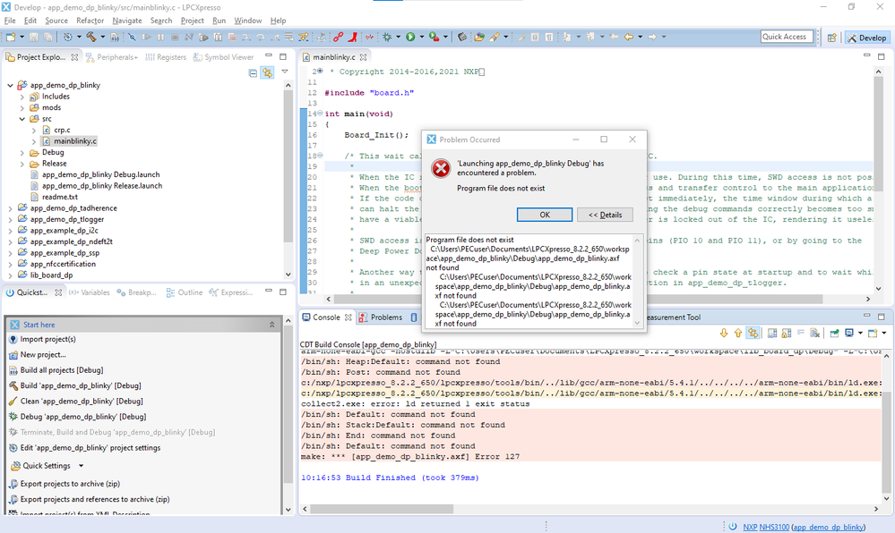

I am using the NHS3152 kit linked to a PC with Windows 10 and LPCXpresso V8.2.2_650 installed. I have installed the plugin "NHS3152 SDK-v12.5" (release_mra_2_12_5).
When trying to debug the example project "app_demo_dp_blinky", I get message "Errors exist in the active configuration of project app_demo_dp_blinky. Proceed with launch?". Then I select the button "Proceed" and I get the following error:LPCXpresso_error_message.pngLPCXpresso_error_message.png
How can I solve the problem?
Another question: what IDE works with NHS3152 with LPC-Link2 board: LPCXpresso or MCUXpresso? I am a bit confused ... (on the web page "NHS3152 General Starter Kit" it suggest LPCXpresso, but in the web page "LPCXpresso IDE v8.2.2" it reccomend MCUXpresso for LPC Cortex-M based microcontrollers)

Hello Sebastiano,
1) NHS SDK version12.5 moved to MCUXpresso and is unfortunately not LPCXpresso compatible.
Use MCUXpresso version 10.2.1 as this version is compatible with the NHS3xxx plugin..
https://www.nxp.com/products/rfid-nfc/nfc-hf/ntag-smartsensor/ntag-smartsensor-with-temperature-sens...
When switching to MCUXpresso I recommend starting a new blank workspace and do a fresh import of the SDK example(s).
2) MCUXpresso can use LPC-LINK2 as a flashing and debugging interface.
