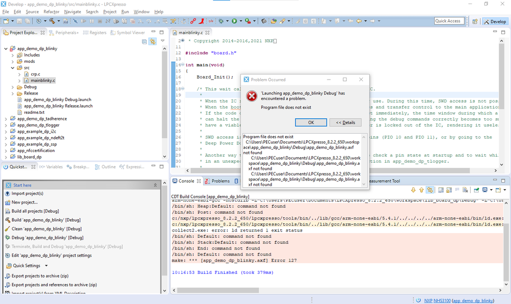

I am using the NHS3152 kit linked to a PC with Windows 10 and LPCXpresso V8.2.2_650 installed. I have installed the plugin "NHS3152 SDK-v12.5" (release_mra_2_12_5).
When trying to debug the example project "app_demo_dp_blinky", I get message "Errors exist in the active configuration of project app_demo_dp_blinky. Proceed with launch?". Then I select the button "Proceed" and I get the following error:LPCXpresso_error_message.pngLPCXpresso_error_message.png
How can I solve the problem?

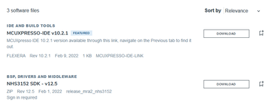

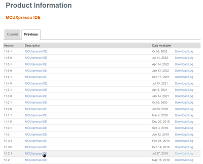

1) NHS SDK version12.5 moved to MCUXpresso and is unfortunately not LPCXpresso compatible.
Use MCUXpresso version 10.2.1 as this version is compatible with the NHS3xxx plugin..
https://www.nxp.com/products/rfid-nfc/nfc-hf/ntag-smartsensor/ntag-smartsensor-with-temperature-sens...
When switching to MCUXpresso I recommend starting a new blank workspace and do a fresh import of the SDK example(s).
2) MCUXpresso can use LPC-LINK2 as a flashing and debugging interface.
