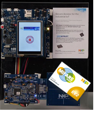

This post contains a guide of how to use LPC55S69 demoboard with other NXP demoboards to demonstrate Access control using NFC, one embedded secure element and an MCU (see picture below). A ready to use package including preparation of a secure element, and of a MIFARE DESFire EV2 card can be used as 3-step authentication example using symmetric AES keys; a session key will be generated inside SE050 which will be exported to LPC55S69 which will handle contactless communication thru CLRC663 plus frontend.

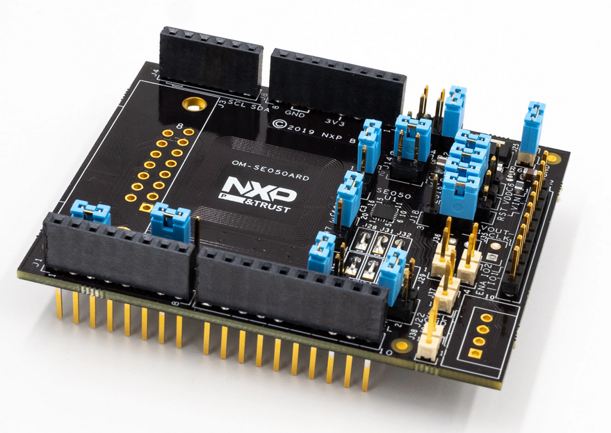

2. Overview of OM-SE050ARD demoboard:
The OM-SE050ARD is the flexible and easy-to-use development kit for the EdgeLock SE050 Plug & Trust product family. It can be used in various ways for example via the Arduino interface compatible to any board featuring an Arduino compatible header, including many i.MX, LPC and Kinetis boards, or via a direct I2C connection. This kit allows evaluation of the SE050 product family features and simplifies the development of secure IoT applications. More information can be found in the respective Application Note AN12395.

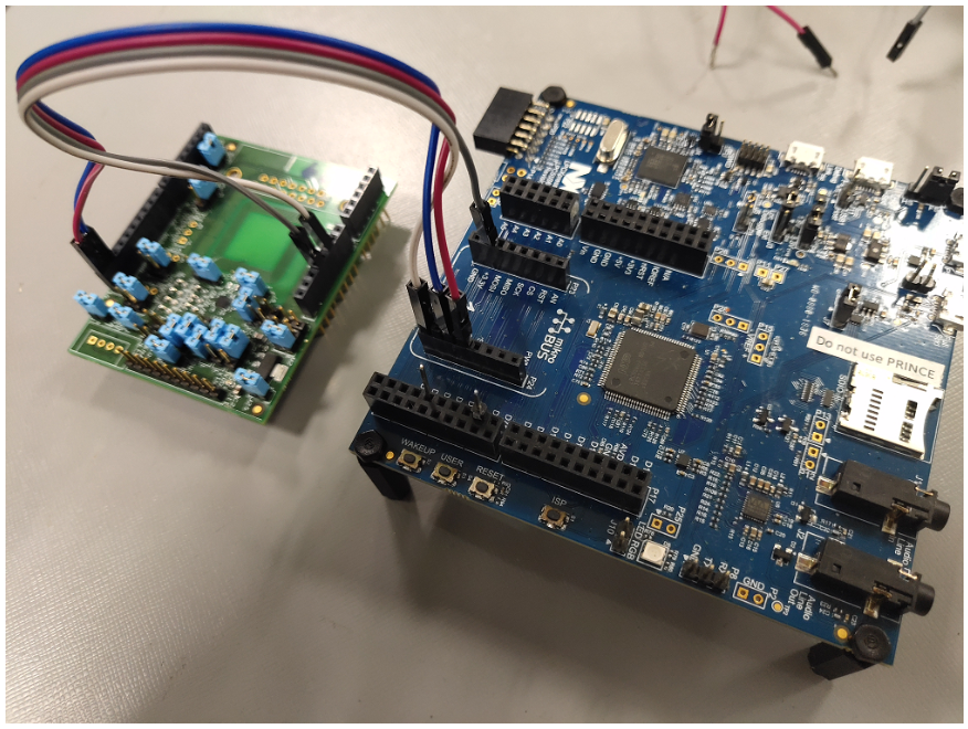

2.1 Connections between OM-SE050ARD and LPC55S69 EVK
OM-SE050ARD
LPC55S69 (Conn.# - Pin #)
Port
Function Name
SE_SDA (J22-1)
P24-6 also P17-3
PIO1_21
FC4_I2C_SDA_ARD
SE_SCL (J22-4)
P24-5 also P17-1
PIO1_20
FC4_I2C_SCL_ARD
+5V_PC (J22-2)
VDD_TARGET
GND (J22-3)
GND

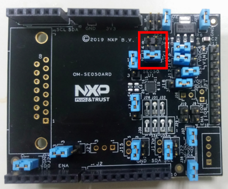

2.2 Jumper settings on OM-SE050ARD to connect it to LPC55S69 EVK
Connect SE050 to LPC55S Arduino stackable headers and change jumper J14 as:
This connects SE_VDD directly to 3V3 and bypasses enable signal. This is required because enable pin on LPC55S coincides with Silex-2401 SPI pins so we cannot use SE_EN signal to drive SE_VDD.

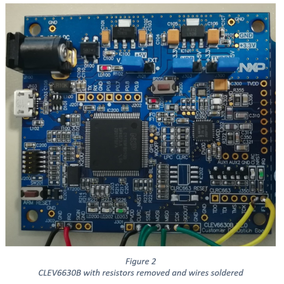

3.2 CLEV6630B board:
The CLEV6630B board consists of CLRC663 plus (NFC frontend) connected by default to an LPC1769 µC via SPI. However, the board is made in such a way that the LPC1769 MCU can be bypassed to connect to an external MCU (in our case the LPC55S69) easily. For doing so:
  • Six resistors from the board need to be removed. These are highlighted in red in the Figure 1:pastedImage_14.png
  • Use the SPI pin connectors available on the left-hand side, on the board edge to connect to external MCU (LPC55S69 in this case)
  • Solder jumper wires onto the following pins of CLEV6630B Board:
    • GND
    • IRQ
    • CLRC_NRST
    • SSEL
    • MOSI
    • MISO
    • SCK
    • IF0
    • IF1
The CLEV6630B is shown in Figure 2 after the required changes have been made to it (Removal of resistors and soldering of wires).

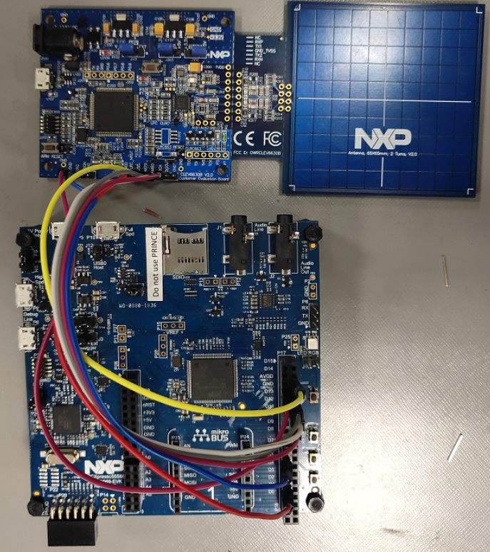

Now connect the two boards as follows:
Signal function
LPC55S69 (conn. # - Pin #)
Port
CLEV6630B
MOSI
P17-10
PIO0_20
MOSI
MISO
P17-12
PIO0_19
MISO
SPI SCK
P17-14
PIO0_21
SCK
SPI CSEL
P17-6
PIO1_11
SSEL
RESET
P18-11
PIO0_15
CLRCL_NRST
IRQ
P18-3
PIO1_10
IRQ
GND
P17-7
GND
 As final touch to this demonstrator, one LCD display will be added in order to show "access control" check result when approaching a MIFARE DESFire EV2 card to the Reader antenna, without the use of a computer console.

  8. The project should be running now. The project contains a closed loop that tries to check presence of a card on top of Reader. Here is how the output looks like in LCD Display.
  9. Press the button reset, and you will see the text "Secure Access to Industrial IOT demo 2019"
  10. PICTURE TO BE UPDATED
  11. Then press the button "Wake-up". Afterwards NFC reader will enter in a loop in which he will look for a card to authenticate. If there are no cards, he will soon show the red allert with text "Access denied"
  12. Bring any NFC card near the frontend’s antenna (or in presence of no card) LCD display will show a message in RED "ACCESS DENIED".
  13. PICTURE TO BE UPDATED
  14. Only in case the "prepared DESFire EV2" card is placed on top of reader, in the picture below, we can see message in GREEN "ACCESS GRANTED"
  15. PICTURE TO BE UPDATED.
