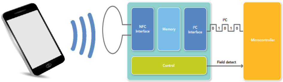

NTAG I2C plus tag ICs offer both, a contact (I2C) and a contactless interface (NFC) to ease the development of IoT, home-automation and consumer applications.
The target of this document and the example projects is to show how NTAG I2C plus can act as the bridge from a host NFC device, like a smartphone or PC, to an embedded board such as a Kinetis Freedom board. 2 main functionalities are demonstrated: embedded board control via NFC and firmware upgrades over NFC.

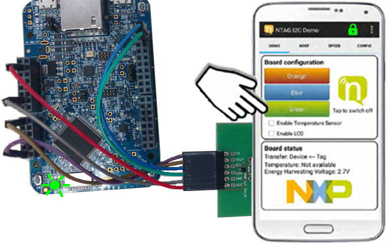

The next picture shows the setup and connections from the NTAG I2C Plus antenna board to the FRDM-K64F.
Hardware
- Kinetis Freedom board FRDM-K64F
- NTAG I2C Plus Antenna board or flex antenna with the NTAG I2C plus IC.

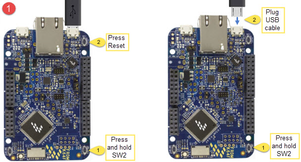

1- In FRDM-K64F, SW2 must be pressed during reset to enter bootloader mode. Hence the 2 usual ways are:+
A) If the board is powered, press and hold SW2 and then press Reset button.
B) When the board is not powered, press and hold SW2 and then plug the USB cable.

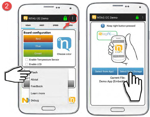

2- From the Android demo app go to the "Flash" option. Then click on "Select from Storage" to browse for the application binary file.
:smileyinfo: Note: For this bootloader example, the application including the vector table must be relocated to an offset of 0x4000 in Flash.

- Bring the NFC enabled phone near the NTAG I2C Antenna.
- Verify transfer is already in progress, by checking the "Board Status".
- Press the Orange/Blue/Green buttons in the Android app
to change the color of the RGB LED.
- Enable the checkbox for "Enable Temperature Sensor" to
see the reading of the K64 internal temperature.
