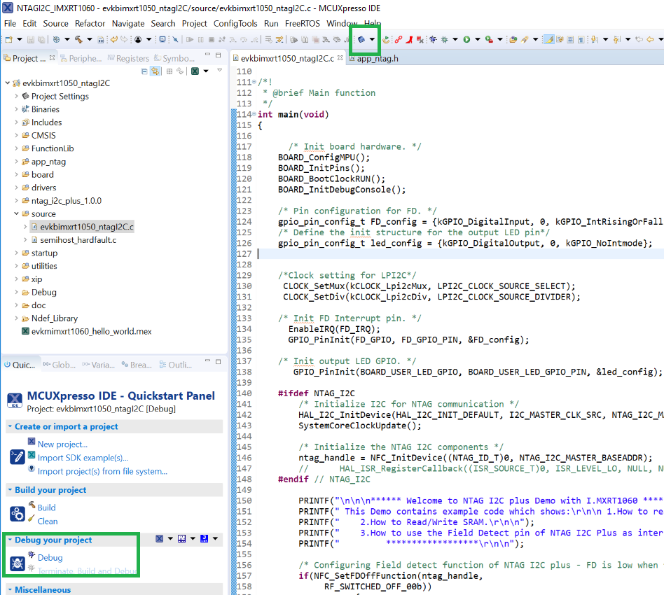

- Download the ‘evkbimxrt1060_ntagI2C’ package which you will find attached to this post.
- Drag and drop the downloaded package to your MCUXpresso IDE workspace (If you don’t have MCUXpresso, it can be downloaded for free from here: https://www.nxp.com/support/developer-resources/software-development-tools/mcuxpresso-software-and-t...
- Now that the package has been imported to the MCUXpresso IDE, click on Debug icon from the Quickstart panel to begin a debug session. Once the debug session has started click on the run icon to run the code:
Note: If this is your first time using IMXRT1060EVK board, it is recommended to follow the getting started guide first ( i.MX RT1060 Evaluation Kit | NXP )
- To see the output, you need to have a terminal application installed (like Tera term or PuTTY). The output looks like this:

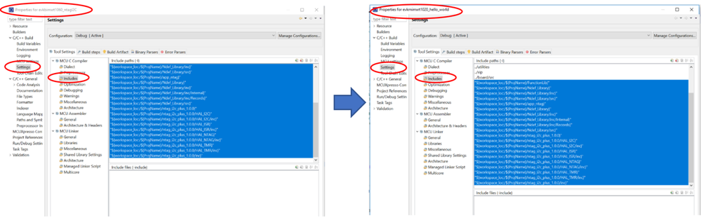

- Now we need to change the project configuration:
a. Add the newly copied folders to source location; Right click on Project->Properties and add the following folders:
b. Include paths to the added libraries in the project. These can be copied from the from ‘evkbimxrt1060_ntagI2C’ or ‘evkbimxrt1050_ntagI2C’ package. Open project->properties and copy the following in the respective places as shown in the images:

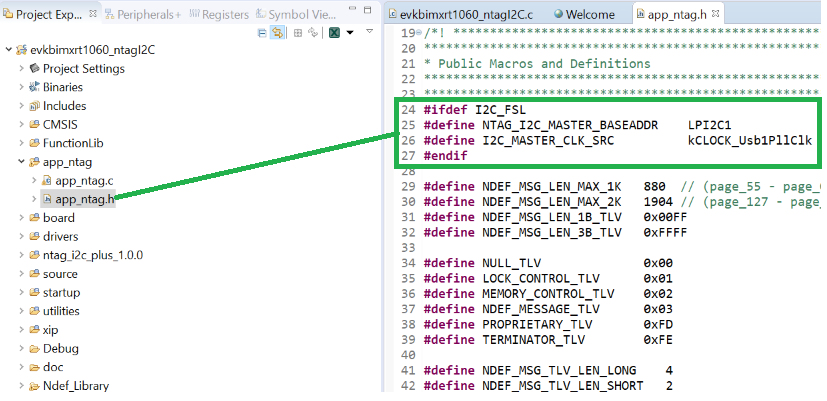

- Change pin configurations according to the board pins you are using:
a. For changing field detect pin, the code can be found in the source file:
b. For I2C instance, the lines of code are in app_ntag->app_ntag.h:
c. These pins also need to be initialized which can be done through the pin initialization tool of MCUXpresso or code can be added to the ‘board.c’ file in ‘board’ folder.
