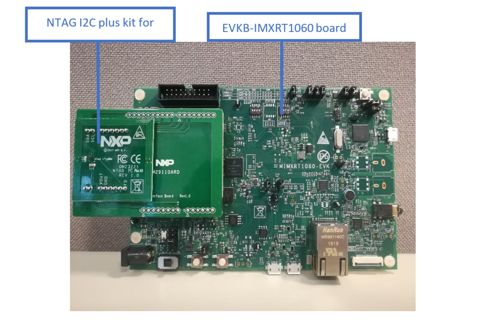

Using NTAG I²C plus kit for Arduino pinout with EVKB-IMXRT1060
The hardware connections are simple. Both the EVKB-IMXRT1060 board and OM23221ARD (NTAG I²C plus) board have Arduino interface. So simply connect both as shown in figure:
Running the Demo
Follow the below mentioned steps to run the demo:

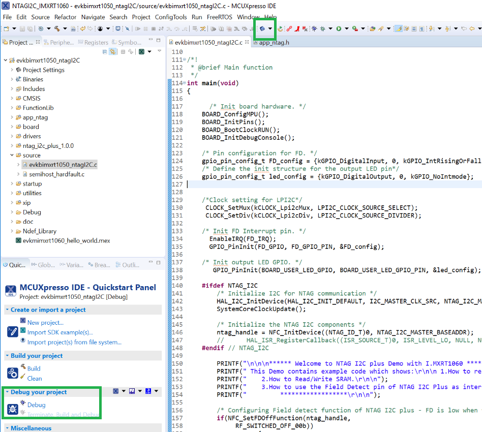

  1. Download the ‘evkbimxrt1060_ntagI2C’ package which you will find attached to this post.
  2. Drag and drop the downloaded package to your MCUXpresso IDE workspace (If you don’t have MCUXpresso, it can be downloaded for free from here: https://www.nxp.com/support/developer-resources/software-development-tools/mcuxpresso-software-and-t...

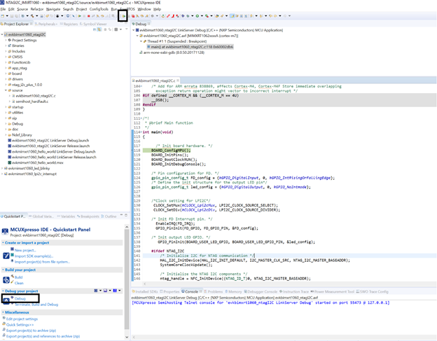

  3. Now that the package has been imported to the MCUXpresso IDE, click on Debug icon from the Quickstart panel to begin a debug session. Once the debug session has started click on the run icon to run the code:                                pastedImage_52.png
    Note:  If this is your first time using IMXRT1060EVK board, it is recommended to follow the getting started guide first ( i.MX RT1060 Evaluation Kit | NXP  )

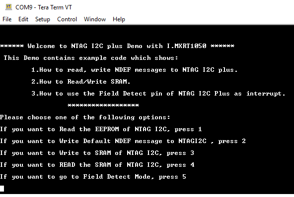

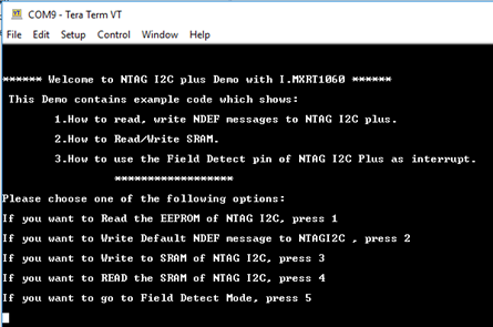

  4. To see the output, you need to have a terminal application installed (like Tera term or PuTTY). The output looks like this:

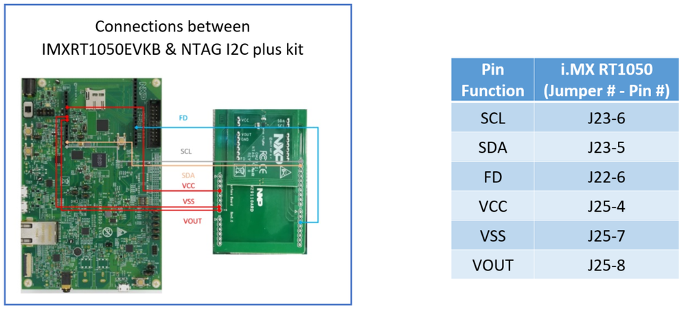

Hardware Connections
In case of EVKB-IMXRT1050, the I2C pins on the Arduino interface’s J24 pin 9 and 10 are only connected to the i.MX RT slave I²C port, not to a master I²C port. So, we cannot just plug in the NTAG I²C plus kit, instead we need to connect two boards with the help of jumper wires. The connections required are show in figure below.

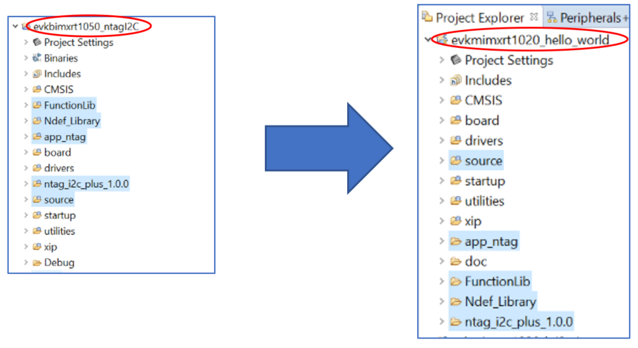

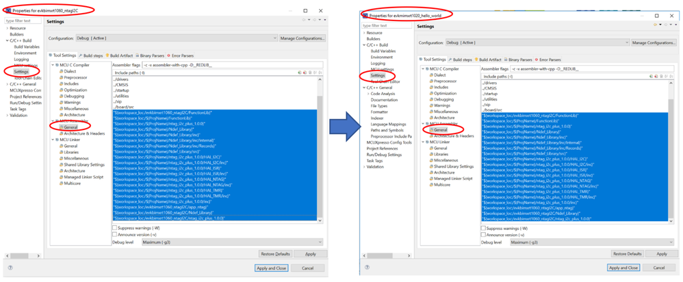

Porting the Package to any other i.MX RT Boards
   If you want to use NTAG I²C plus with i.MX RT boards other than the i.MX RT1050 or the i.MX RT1060, then you’ve       to port the example package. This is fairly straightforward and the procedure is described below:

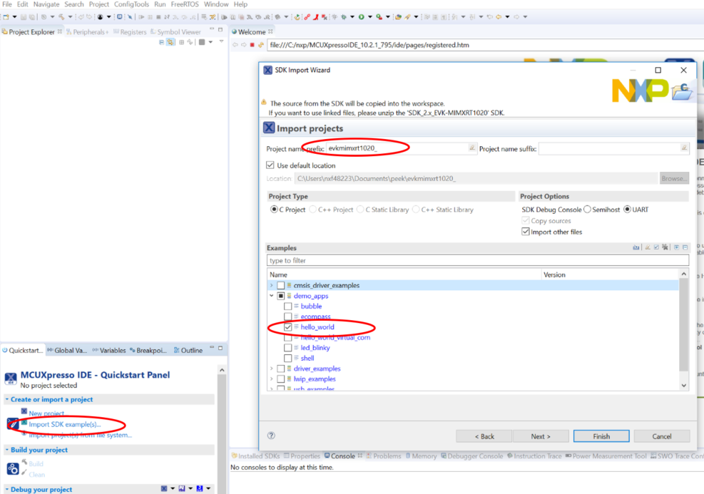

  1. Import the ‘hello world’ project from the SDK of the board to which you want to port the package. (SDKs for every board are freely available for download from the MCUXpresso SDK Builder website).We will modify this ‘hello world’ project adding code from attached packages, to make it work on the desired board.
  2. Copy the following folders from the attached ‘evkbimxrt1060_ntagI2C’ or ‘evkbimxrt1050_ntagI2C’ package to the ‘hello world’ project imported in step 1:

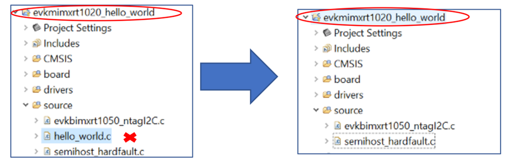

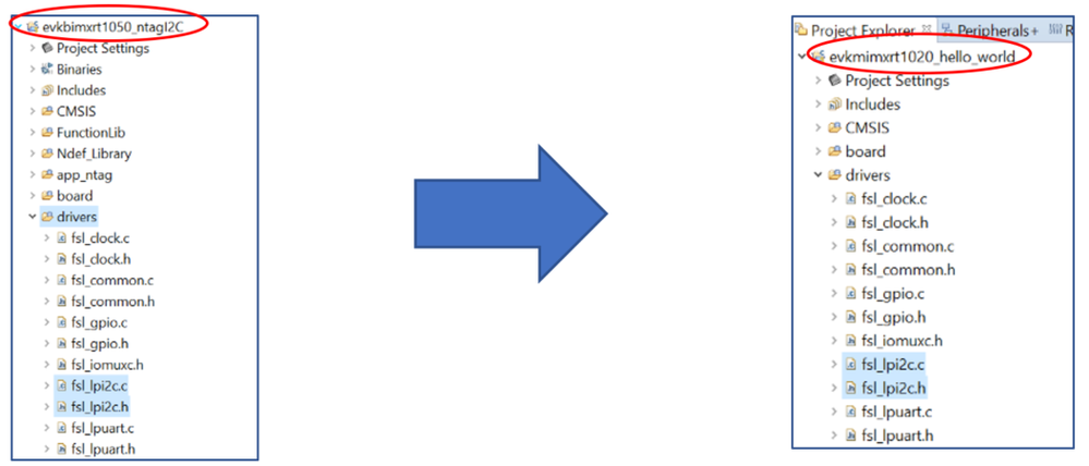

    Copy the two files to the ‘drivers’ folder of ‘hello world’ project:
    Delete the ‘hello_world.c’ file from the source folder:

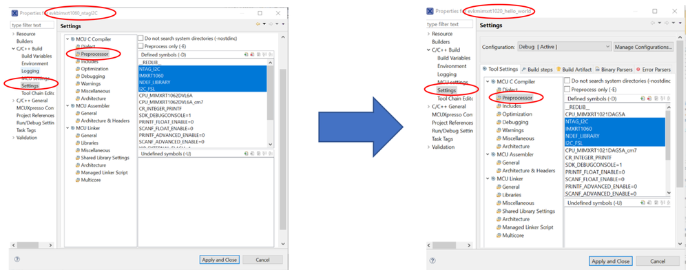

  3. Now copy the following preprocessor micros from ‘evkbimxrt1060_ntagI2C’ or ‘evkbimxrt1050_ntagI2C’ package to ‘hello world’ project:
         Preprocessor settings can be found by right clicking Project-Properties>C++Build > Settings
  4.  Now we need to change the project configuration:

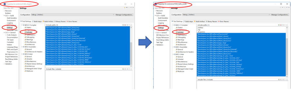

          a.  Add the newly copied folders to source location; Right click on Project->Properties and add the following        folders:
    b.  Include paths to the added libraries in the project. These can be copied from the from ‘evkbimxrt1060_ntagI2C’ or ‘evkbimxrt1050_ntagI2C’ package. Open project->properties and copy the following in the respective places as shown in the images:

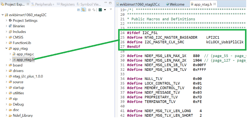

  5. Change pin configurations according to the board pins you are using:
                a. For changing field detect pin, the code can be found in the source file:
    b. For I2C instance, the lines of code are in app_ntag->app_ntag.h:
     c. These pins also need to be initialized which can be done through the pin initialization tool of MCUXpresso or code can be added to the ‘board.c’ file in ‘board’ folder.
  6. Once these changes are done, porting is complete. Build the project, it should build without any errors.
