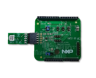

  1. NTAG 5 Evaluation Board (OM23510ARD)
                     OM23510ARD

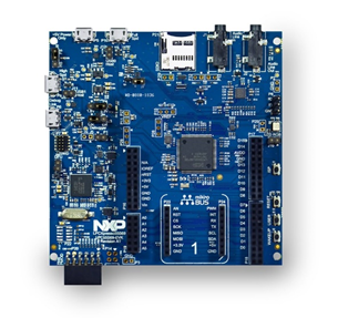

 2. LPCXpresso55S69 Board

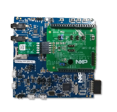

Hardware Connections
Connecting the two boards is very easy since both have Arduino compatible headers, so simply plug the NTAG 5 EVK board on top of the LPCXpresso55S69 board.pastedImage_42.png pastedImage_43.png

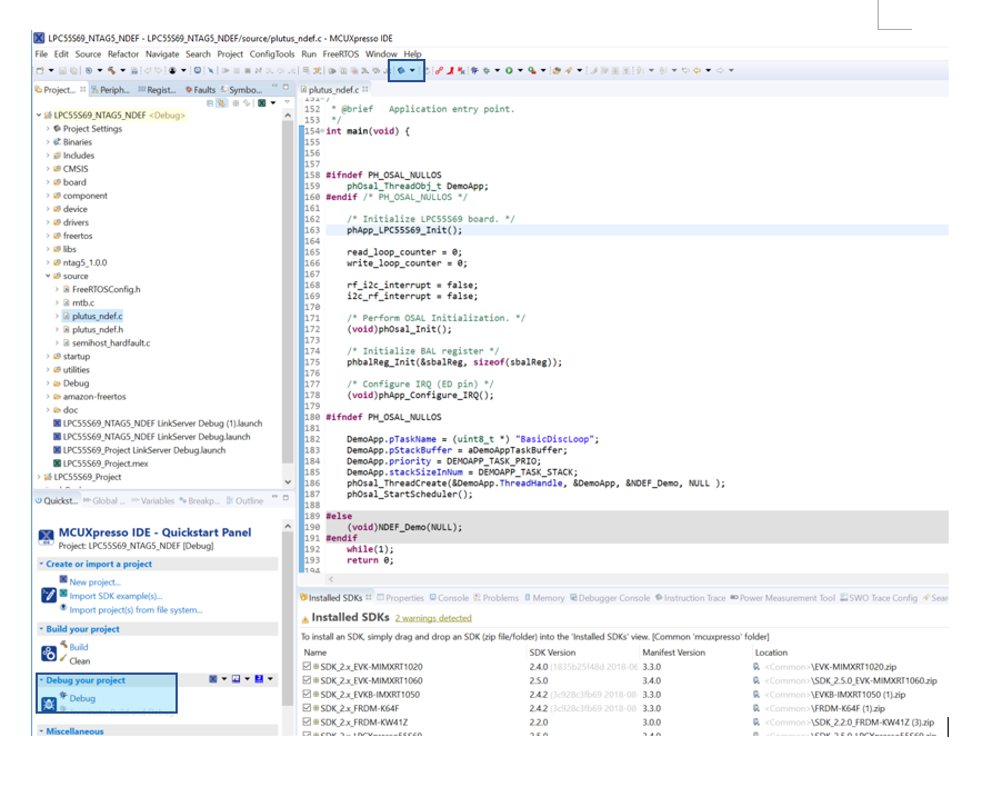

1. Running 'Simple_NDEF' on LPC55S69 with NTAG 5
  1. If this is the first time you’re using the LPCXpresso55S69 board, follow the getting started guide first LPC55S69-EVK. Make sure to install the SDK package for the LPC55S69 board which is required to run the project.
  2. Download the ‘Simple_NDEF’ package which you will find attached to this post.
  3. Drag and drop the downloaded package to the “Project Explorer” tab of your MCUXpresso IDE workspace (If you don’t have MCUXpresso, it can be downloaded for free from here:https://www.nxp.com/support/developer-resources/software-development-tools/mcuxpresso-software-and-t...
  4. Now that the package has been imported to the MCUXpresso IDE (via drag and drop), click on the Debug icon from the Quickstart panel to begin a debug session. Once the debug session has started, click on the run icon to run the code:

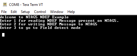

5. After step 3, the project should be running now. Here is how the output looks in the terminal:

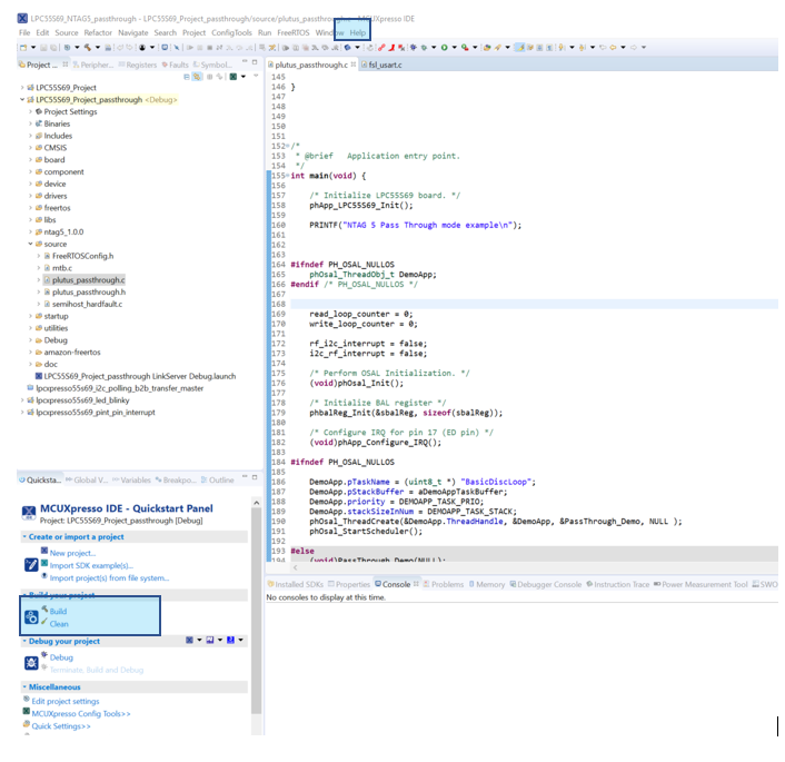

2. Running 'Passthrough' on LPC55S69 with NTAG5
  1. If this is the first time you’re using the LPCXpresso55S69 board, follow the getting started guide first an LPC55S69-EVK | NXP. Make sure to install the SDK package for the LPC55S69 board which is required to run the project.
  2. Download the ‘Passthrough’ package which you will find attached to this post.
5. After step 3, the project should be running now. To check the passthrough functionality, install the NTAG 5 App and then go into passthrough functionality.
