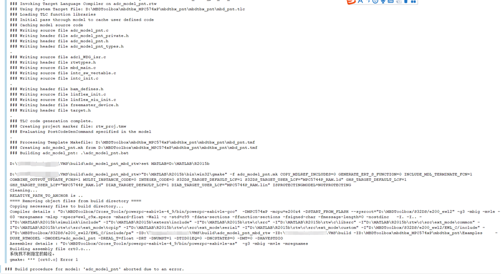

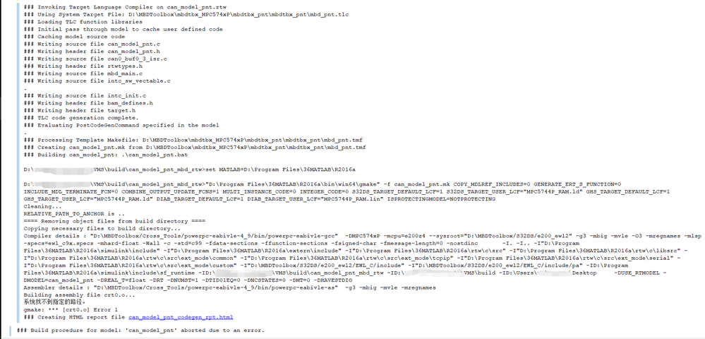

Hello, I used MBD Toolbox for MPC574xP in simulink. And I want to flash the .elf file to the board. But after build in MATLAB, I can't find the .elf file in the xxx_rtw folder. I have tried it in MATLAB 2016a and 2015b, but both have this problem. By the way, my MBD Toolbox's version is 2.0.

lynnelee
HI, dumitru-daniel.popa,
Thank you for your reply. For some reason we have to use the MBD Toolbox 2.0 version. And following is the messages showed in my Diagnostic Viewer.

Daniel_Popa
Hi lynnelee‌,
Your problem is related with the fact that MATLAB 2016a is installed in "Program Files" that contains a space. The special characters are not handle correctly by the MATLAB Embedded Coder Make File, hence it is required to try to reinstall the MATLAB in a path without any special characters and as short as possible.
Can you try that ?
Hope this will resolve your issue.

lynnelee
HI dumitru-daniel.popa,
Thank you for your help. I have tried your solution but it doesn't work. T T
And the following is the new message showed on my Diagnostic Viewer.
Really need your help.
Kind regards,
Lynne

lynnelee
Hi mariuslucianandrei‌,
I'm wondering if your suggestion is to install the S32 Design Studio for Power v1.2.
If so, I have tried it but it still didn't work.
And by the way, the text "系统找不到指定的路径" means that "System can not find the route".
Looking for your help.
