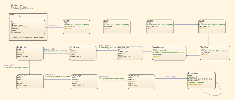

I am trying to initialize FET pre driver (MC33937APEK) for the Motor Control Evaluation Board (MTRCKTSPS5744P).
I followed the initialization procedure (using model based design toolbox for MPC574x). Somehow, I am not able to initialize the pre-driver (model is attached).
Please provide an input for it and where it may be going wrong.
Thank you in advance.

abhishek_kumar1
Dear dumitru-daniel.popa
We were able to find a solution to initialize FET pre driver (MC33937APEK) for the Motor Control Evaluation Board (MTRCKTSPS5744P).
I am attaching the model incase anyone needs it.
Special thanks to @Rafael Barbosa
Best Regards
Abhishek

Daniel_Popa
Hi Abhishek,
Unfortunately, our team does not have such a pre-driver board available, hence we can test the procedure.
The only advice i can provide is to check with an oscilloscope the signals after each step to make sure they are complient with the predriver initialization sequence.

abhishek_kumar1
Thank you for the input. I am currently doing that.
Best Regards
