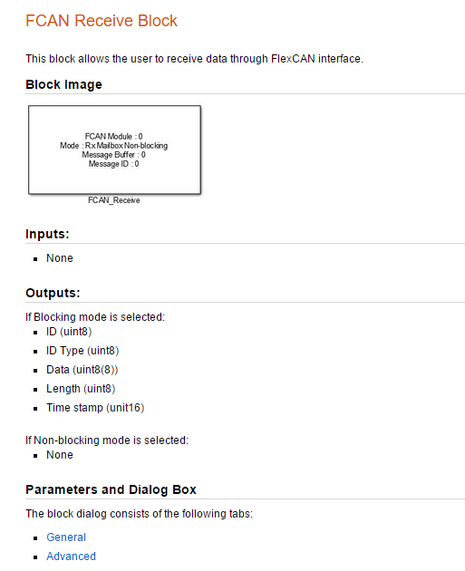

Does anyone know what kind of CAN data does the FCAN module output in simulink?

Hello [email protected]‌,
The CAN receive block outputs data of uint8 type
You can click on the block to open the mask, then click on Help to get more information on all blocks from our toolbox.
