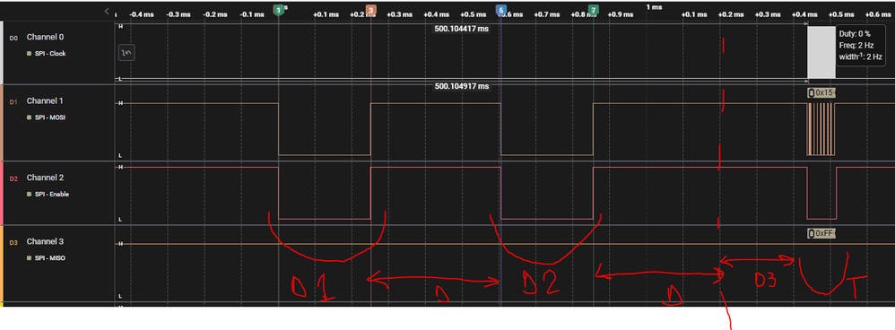

We are working on a 48V BMS where our Main controller is S32K146 and Slave IC is BQ79616. There is an SPI communication IC BQ79600 in between to facilitate SPI comm between Master and Slave.
In order to wakeup the BQ79600, we need to send a wakeup ping on MOSI which is to toggle the GPIO pin used for MOSI.
After this, for fetching data from Slave, we need to access the registers by sending a frame minimum of 6 bytes on SPI. However, the FlexIO MBDT block doesn't have an option for sending more than 4 bytes. Is there a work around this problem?
Is it possible to achieve this if we change from FlexIO to LPSPI?
We are trying to avoid getting too much into bare metal coding to fasten the development process. Need immediate assistance on this as the entire project is at stake.

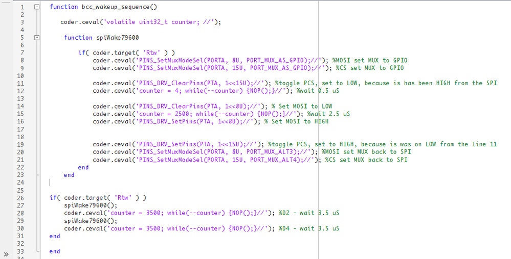

On the step function, you can observe that we have multiple intervals, on both MOSI and CS pins as described in the code snippet you have provided.
D1 = SpiWake79600();
D2  = delayus (3500);
D3 = SpiWake79600();
D4 = delayus(3500);
D5 = additional time used between calls, this could be extracted from the the D4, when the call shall be actually 600 NOPS

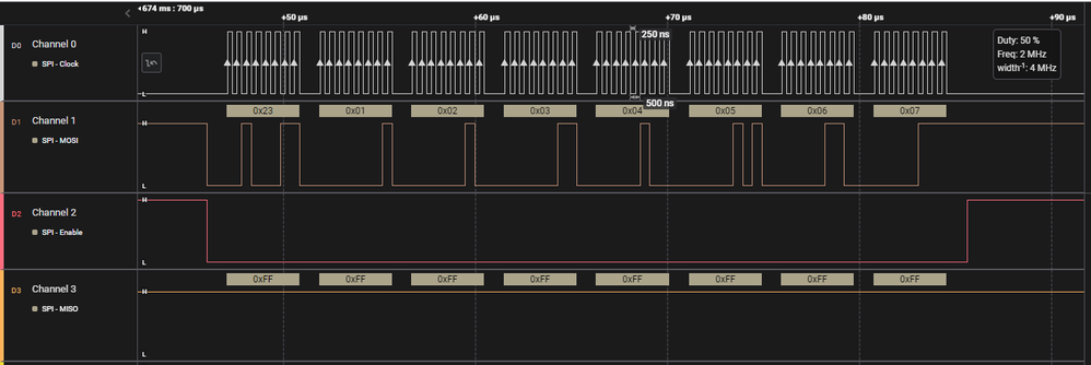

mariuslucianand_0-1694094117508.pngmariuslucianand_0-1694094117508.pngNow, for the actual transfer, we are using the Continous transfer as explained in the thread above and the data transmitted is a counter value, which in this case is [0x23 followed by 0x01 0x02 0x03 0x04 0x05 0x06 0x07]. For the entire 8-byte packet, the CS pin was set to low.  In this way, you could send variable messages of different byte sizes.

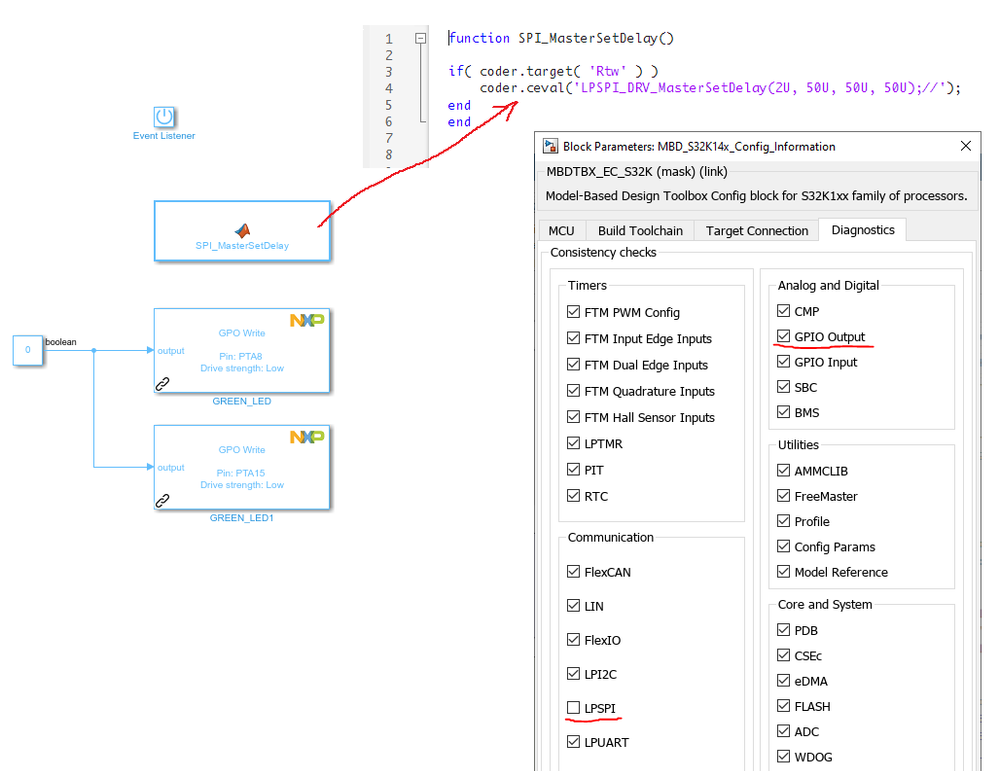

1. In the initialize subsystem there 2 types of blocks. There is a custom code, that sets the delay between the SPI bytes, this could be adjusted by hand. Also, there are 2 GPO blocks that also configure the MISO and CS pins as GPIO, but we will change the MUX inside the other custom code part. MBDT automatically cross-checks the pins so that the same pin is not used on different peripherals. We shall disable the check for the SPI inside the main config block.
2.  The actual delay has been generated using custom code. You can see the code snippet below together with additional comments. You could adjust the D4 from line number 30.  The way in which we are using the custom code, has been described in the following article: https://community.nxp.com/t5/NXP-Model-Based-Design-Tools/How-to-use-your-own-C-code-in-our-Toolbox-...

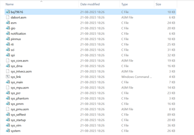

KVK
Hi @mariuslucianand
Now that the BQ79656 BMS IC is up and running, we are now trying to figure out the configurations and SPI communication part.
I have attached the Sample code for the IC. I want to understand how to implement it using MBDT.
Vamshi

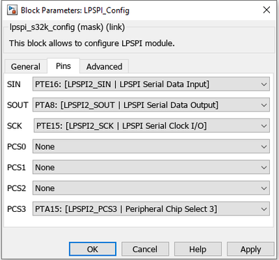

1. SPI instance and pin details
LPSPI Instance: 2
 2. MATLAB Version: MATLAB 2023a
Kindly do provide the code for using SPI pins as GPIO pins and details to include the same in MATLAB model.

mariuslucianand
Hello @KVK,
Please find attached the model with the custom code that you have requested.
D4 = delayus(3500);
Important parts inside the models:
I have attached the model. Please try it on your side and let me know if there are additional questions!
Hope this helps,
Marius

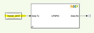

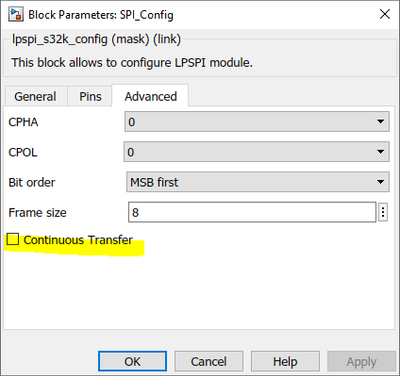

For such a task, I would suggest using the native LPSPI instead of FlexIO. My guess here is that the CS pin needs to remain asserted as long as the transfer of the minimum 6-byte frame is performed. You could achieve this using the Continuous transfer, the Advanced option of the SPI_Config block.
When this Continuous transfer option is used if an array is sent using the LPSPI transfer block, then for the entire size of the Data TX buffer the CS pin is asserted and the transfer for a minimum of 6 bytes is performed. If the master_send array has 8 8-byte commands, then the LPSPI will send the 8-byte frame.

1. Which SPI instance and pins are you planning to use, so that we can give you an example of how to wake up the device using the MOSI pin as you have described in the initial question?
