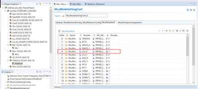

In Mcu, based on your hardware LCU instance configured in Mcl, enable the peripheral clock:

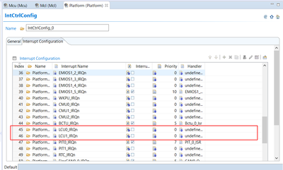

In the Platform component, you can find the interrupt section related to the hardware LCU instances.

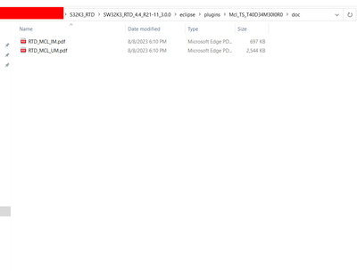

Secondly, the MBDT for S32K3xx generates code based on RTD (Real Time Drivers) MCAL components.  For more details about configuring a specific component, you could check the RTD documentation that is found inside the RTD folder in our toolbox root.
Based on my suggestions and the information found in the RTD documentation, please update the configuration project and see if the issue has been solved.

Indeed, the hard fault was caused by the LCU clock not being enabled. Thank you for pointing it out.

Also, thank you for providing the location of the documentation for the MCAL drivers. I had already found some RTD user manual, but it's the first time I am seeing all of them in the same place, as well as Integration manuals. I'm certain they will prove pretty useful.
