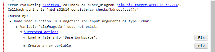

after the Installation of R2017b I get this error after I want to build a model.
Undefined function 'slsfnagctlr' for input arguments of type 'char'.
The Simulation runs successfully.
With R2017a Release the build of the model works.
Does anybody know this error and could help ?

Is there also a Hotfix for S32K v2.0 on Release R2017b ?
4,673 Views
Daniel_Popa
There is no fix for v2.0.0 since it has been replaced by https://community.nxp.com/docs/DOC-335555

I'm using the Kinetis Toolbox.
Leon
4,672 Views
constantinrazva
Hi lethuer‌,
Please do the following:
copy slsfnagctlr.p file from attached zip into {YOUR_KINETIS_TOOLBOX_ROOT}\mctbx_kv*xf\mscripts
This should do the trick.
Let me know if you encounter other problems with the new Matlab version.

I do not have exactly such a path...
But I copied it to the following Folder and the build process is works now !
C:\MCToolbox\mctbx_Kinetis\mctbx_kv4xf\mctbx_kv4xf\mscripts
Thank you for Support !
Leon
4,672 Views
constantinrazva
Hello lethuer‌,
You did it right. I used * in mctbx_kv*xf\mscripts as I did not know if you had kv3, kv4 or other KV board.
Razvan.

Can you tell us what toolbox are you using?
For example, we have a fix for MPC564xL available here: HotFix: MBD Toolbox rev1.3.0 for MPC564xL .
