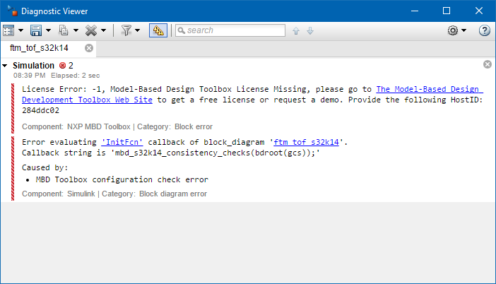

Like discussed here https://community.nxp.com/thread/467938#comment-980540 I wanted to use S32Kv3.0.0 toolbox with R2017b and got this license error:
I made all the steps recommended and completely new downloaded and installed the toolbox.
- I generated a new license file and saved it with the file extension .lic to the installation folder
- RESET the MATLAB default paths to DEFAULT using the Set Path menu to remove all previous toolboxes
- run the mbd_s32K_path.m to add the S32K1xx into MATLAB
- added the lic folder manually to the Matlab paths
In opposite to v2.0 (which does not work with R2017b) I was not able to change the path during installation of v3.0.
So now I simply copied the installed content of v3.0 toolbox from the automatic generated path to a different folder and that solved the problem after simply running the mbd_s32K_path.m again.
Maybe the standard installation path was too long or the space in my username leads to some problems so the lic file couldn't be found.

Hi Leon,
Thank you for reporting this and glad to find out you have resolved.
You can change the default Add-Ons installation paths directly from MATLAB Preferences before Toolbox install.
