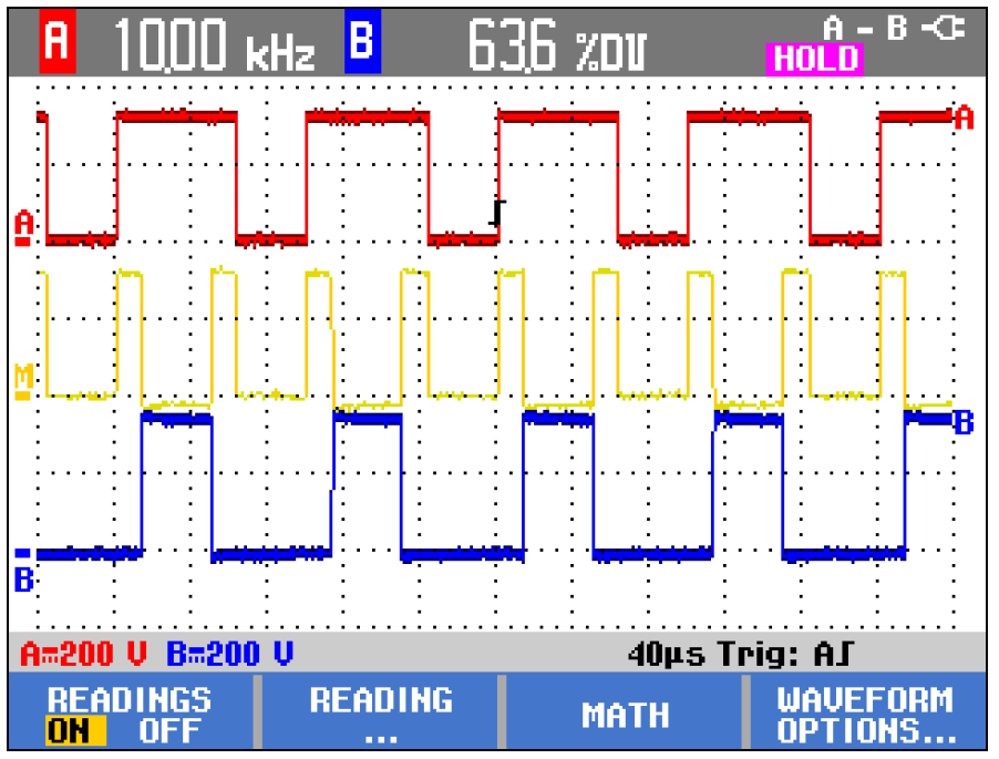

Hello dumitru-daniel.popa‌
like you have shown in module 5 I want to measure the voltages directly with an oscilloscope:
For me it was only possible to get this (Motor is not connected):
A - Terminal Phase A, GND
B - Terminal Phase B, GND
M - A-B (Math Operation)
So the line voltage A-B does not have the same trend as yours.
Mine is only positive or negative because the PWM signals are centered and not shiftet like you signals.
It doesn't madder if I'm using the "eFlexPWM_Three_Phase_Output", three single "eFlexPWM_Complementary_Output" or the "FTM_Three_Phase_Output" block...

Daniel_Popa
Hi Leon,
The commands looks OK. It seems like you are using Center Aligned PWM strategy while on S32K i used edge aligned PWM.
For the KV4 toolbox you can select edge aligned only on Independent output block.
Anyhow that should not be an issue during the operation.

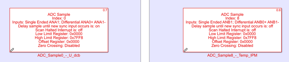

I'm now able to download the code to the target and checked the variables in freemaster (only in polling mode) like you did in module 5 !
The download works anytime successful but it only runs if the Driver Subsystem FNB41560 is commented out.
So the ADC communication makes anything wrong.
Do you see the mistake in the subsystem ?
FNB41560:
ADC Samples:

lethuer
Contributor V
Okay I solved the Problem by myself.
I remembered a few weeks ago and now I used priorities for the blocks to change the execution order.
ADC_Config (priority 1)
ADC StartA (priority 1)
ADC StartB (priority 1)
ADC Samples (priority 2)
I think the Problem was that the ADC Read block was executed before the ADC Start, Sample and Config blocks ?
This blocks always has to be executed before the ADC Read ?

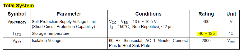

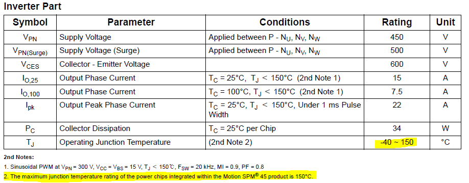

lethuer
Contributor V
Hi Daniel,
In the data sheet I found some information
http://www.mouser.com/ds/2/149/FNB41560-484544.pdf
The "Total System" should be the complete Motion SPM FNB41560 Driver, so as absolut limit I would suggest 125°C.
Leon

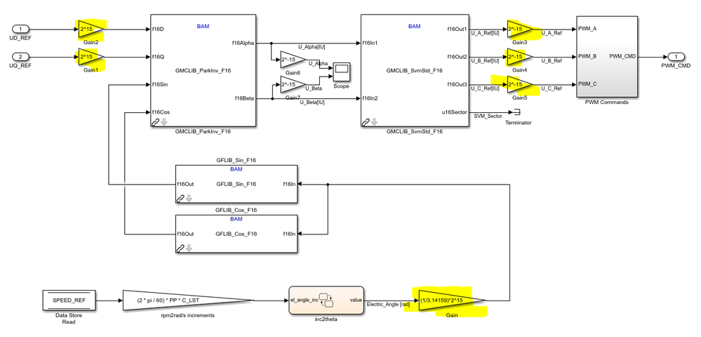

lethuer
Contributor V
Hi wangxuan‌

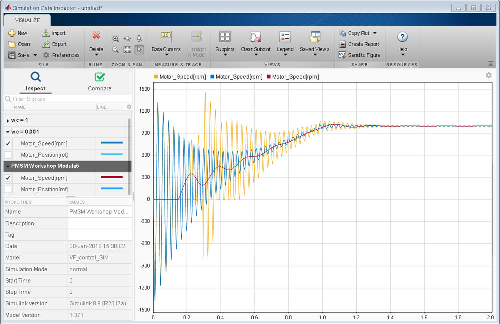

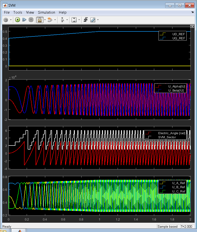

good Job, we are getting closer ! Again I have attached my model.

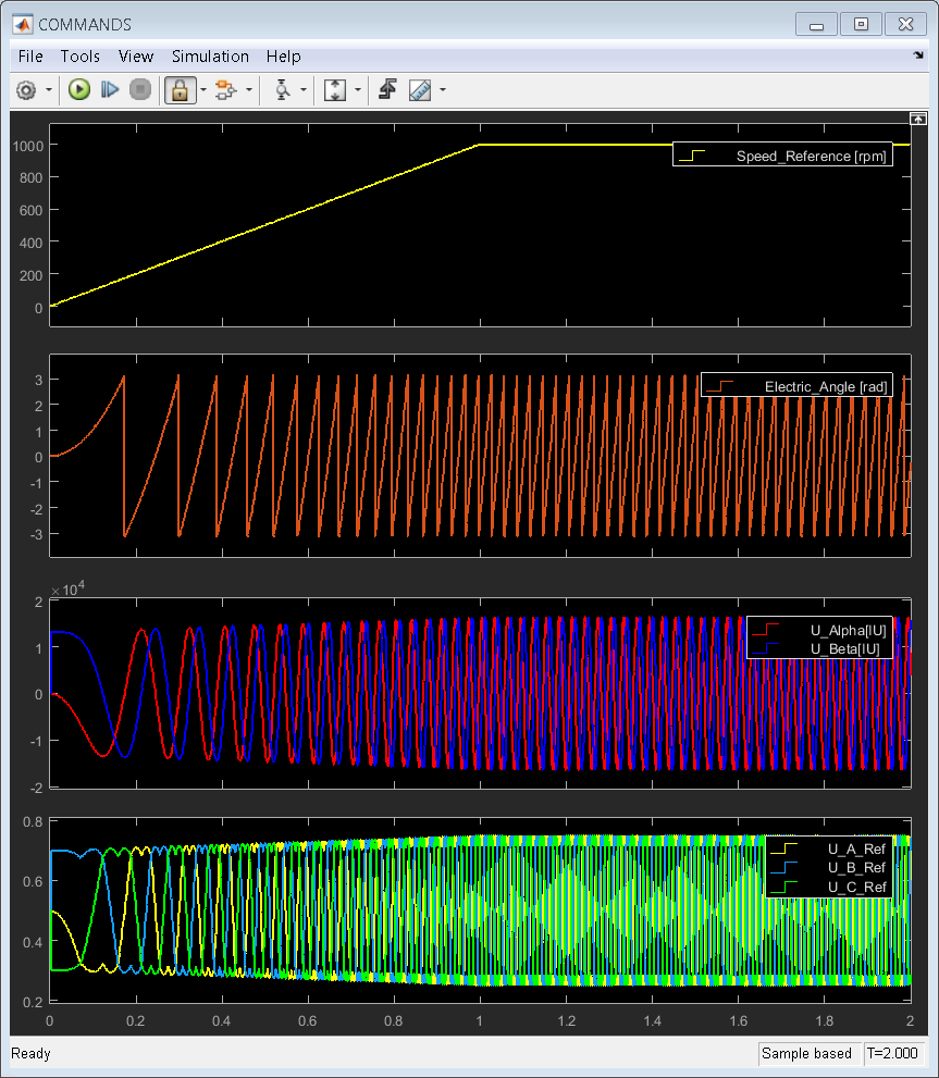

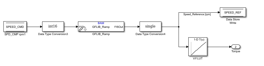

I've seen your / mine / our modified model and think we could use the data type conversation in the Slow Loop Control Subsystem like shown below:
Then the Speed_Reference (yellow line in COMMANDS) is exactly the same like in module 5 s32k example.
Your implemented gains in the Fast Loop Control Subsystem

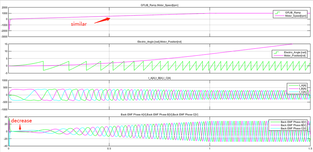

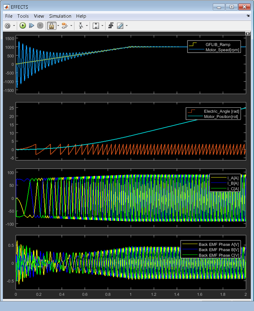

 Now I was able to simulate correctly. Here are the results:
Like you see the COMMANDS and SVM are completely the same like in s32k module 5.
(U_Alpha and U_Beta are still upscaled)

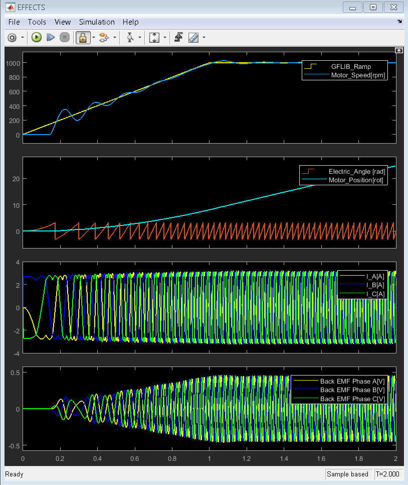

But in EFFECTS we have some differences, the Motor Speed swings extremely:
I have made some Simulation runs (blue --> wc = 0.001; yellow --> wc = 1; red --> original pmsm module5)
How we could get the same result as in the pmsm Workshop module5 (red line) ?
After this step is done we could parametrize our own Motor with the values of R,L and so on.
Another way could be to use the Simscape Power Systems Toolbox instead of the Simulink PMSM model.
Also the Parameters of the LUT in the Slow Loop Control Subsystem I didn't have parametrized yet.
If this is done I want to download the code to the target and see the results in FreeMASTER.
11,672 Views

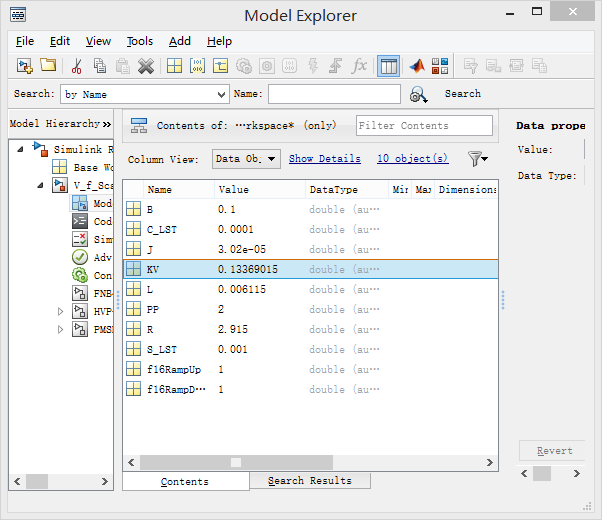

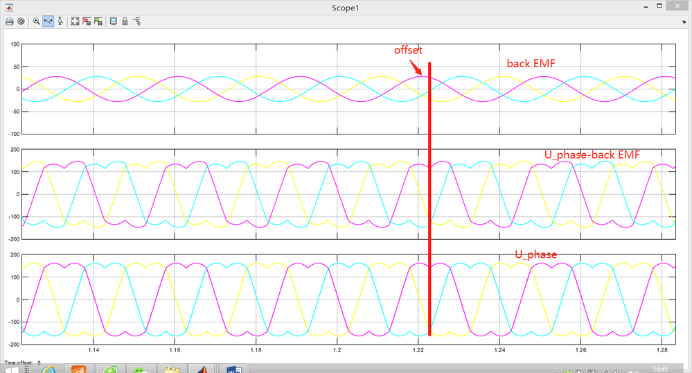

wangxuan
Hi Leon Thürnau,dumitru-daniel.popa
      Good job! I got the same result as yours,  I found that the back EMF we got was very large at the beginning, and the speed oscillations were obvious at this time. I think the problem lies in this (I do not know if I am correct), because rightly, our speed should be small at the outset, So the back-EMF should also be small, I think it should be caused by motor parameters do not match. The bus voltage we needed was 27 times larger, resulting in a large input phase voltage (about 150 times larger). I modified it according to the PMSM motor parameters in Table 1 and the current reached 300A (which seems to be wrong ), The following is the result I got. It seems that the speed oscillation problem appears to be getting better, but the phase current waveform changes greatly compared with the original one. In contrast, because the back EMF phase and the phase voltage phase are offset, Becomes no longer symmetrical. What do you think and correct? Thank you!
motor model
60ST-M01330
Rated power (W)
400
Rated line voltage(V)
220
Rated line current(A)
2.8
Rated speed(rpm)
3000
Rated torque(N.m)
1.27
Peak torque(N.m)
3.8
Back EMF(V/krpm)
28
Torque coefficient(N.m/A)
0.5
Rotor inertia(Kg.m2)
0.302×10-4
Winding (Line) Resistance (Ω)
5.83
Winding (Line) Inductance  (mH)
12.23
Electrical time constant (ms)
2.1
wang xuan
11,672 Views
lethuer
Contributor V
with Udc = 12V in FNB41560 Subsystem and wc = 1 in PMSM model I got the same results like in module5 example.
So in General the Problem is the higher bus voltage and another Motor.
I will try to parametrize my Motor and see what happens.

Daniel_Popa
Hi Wang Xuan,
I have 2 concerns about your results:
#1: Speed goes down in the beginning: possible culprit: friction constant B and/or J
#2: You have huge currents in the motor: possible culprit: R and/or KV
11,672 Views

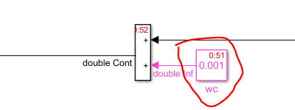

Daniel_Popa
I've looked a bit over the model. I think is an issue related with MATLAB solvers for diff. equations. It looks like you changed the simulation parameters. Mine is using:
Anyhow, you could try to modify the wc initial condition.
You should be able to start see speed & back-emf. If you need further details about the motor - then you can check this one: Dynamic Simulation of Electrical Machines and Drive Systems Using MATLAB GUI | InTechOpen
Hope it helps!

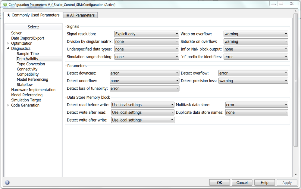

11,672 Views
lethuer

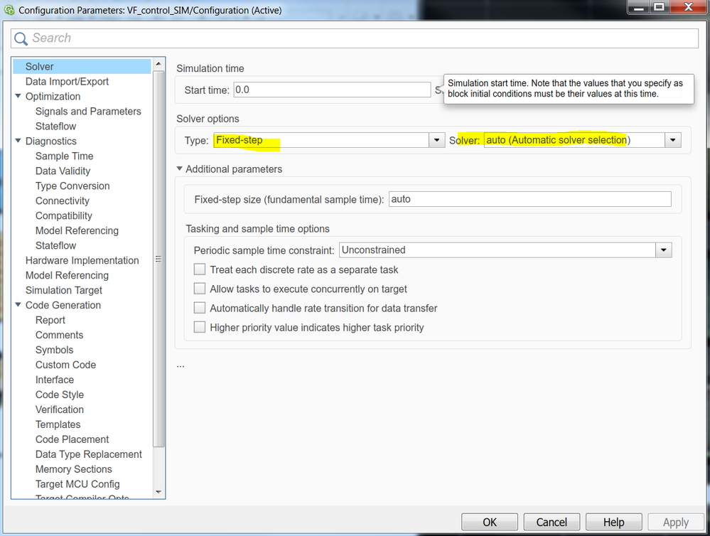

Contributor V
Hi dumitru-daniel.popa‌
I don't have your advanced Parameters in the second Screen:
How could I activate them ?
11,672 Views
Daniel_Popa
Hi Leon,
That depends on MATLAB version you are using. Using an older version might not show them at all. Anyhow - i noticed that some of the parameters can only be found in the "All Parameters" Tab. Try to search it there.
11,671 Views
lethuer
Contributor V
Hi Daniel,
no I'm sorry..
Also in the "All Parameters" tab there are only the Options for "Signals", "Parameters" and "Data Store Memory block" but not your "Advanced Parameters".
Leon
