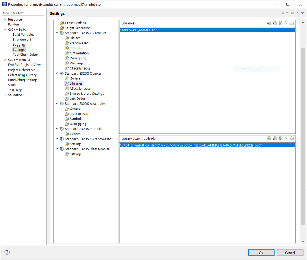

I am using the MBD toolbox 3.0.0 and the target micro-controller is MPC5744P.
I can generate code using GDFLIB blocks (thanks Reference to non-existent field 'info' using GFLIB block ), however I can't debug it (neither flash it in the micro) using S32 Design Studio.
I am using the block GDFLIB_FilterMA_FLT in Simulink.
After code generation and importing the project in S32 Design Studio, I am getting the following error when building project:
Can you support me with this problem?
Please see the example model attached.

This issue is due to missing library from linker arguments. It is an older issue that was fixed in the more recent releases, but the workaround is simply: you right click on the project that you have imported into S32 Design Studio, go to C/C++ Build -> Settings -> Standard S32DS C Linker -> Libraries, and add the following (from the green + signs), as in the picture below:
":MPC574xP_AMMCLIB.a"   -- add this to Libraries
"{TOOLBOX_DIR}\mbdtbx_mpc574x\AMMCLIB_MPC574xP\lib\s32ds_ppc"   -- add this to Library search path
This should do the trick - let me know if you have further issues with it.

Dear constantinrazvan.chivu‌,
Thank you very much for the support, it is working now.
Kind Regards, Rafael
